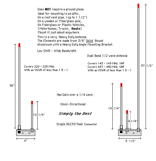

Measuring from the 19-1/4" element end of the angle the holes are at 1/2", 2-7/8", and 5" from edge of angle to hole centers.
