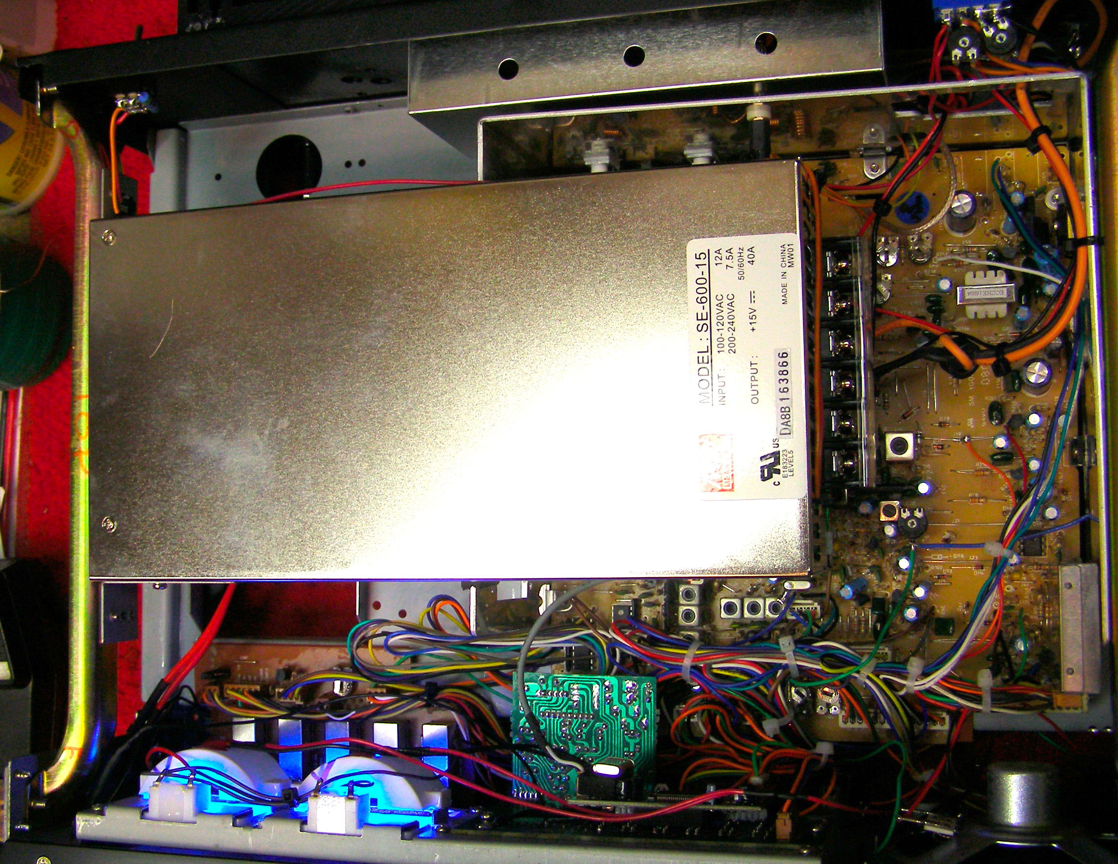

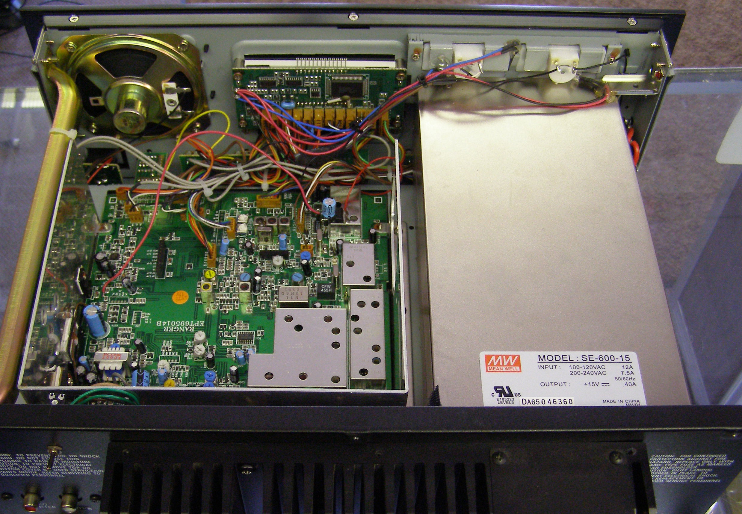

    A local shop does this mod. I have a couple of these 15 VDC 40 amp MeanWell's just waiting to be dropped in but the dang factory power supplies won't fail yet :ROFLMAO: Bare in mind that the fans in the MeanWell's are loud and may warrant a Hi/Lo fan speed switch if you DIY.

    Some are using a smaller 30 amp Meanwell supply. That looks to require less cutting or removal of internal radio parts than the 40 amp'r to fit. The 40 amp @ 15 VDC is the Hot Setup. Again, remember there will be some added cooling fan noise from the new switching power supply.
    Pretty straight forward power supply replacement... Find out what 120VAC power wires go to the old power supply and mark them. Find out what 12VDC wires come out of the original power supply PC board and go to the main radio board and mark them. There is a chance that there may be some other 12VDC power wires that go to the lights, amp etc. (Take a photo of all wiring before you disconnect or cut anything) cut and remove old power supply components such as the transformer, filter caps, power transistors and rectifier board. This makes room for the new power supply. Shoe-horn in new power supply and connect primary the 120VAC wires and secondary 12VDC wires. You could fuse those secondary 12VDC wires if you like for some added protection.
