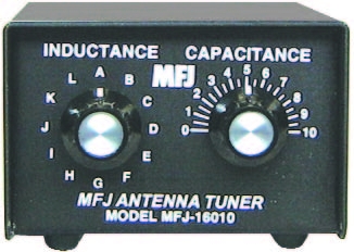

Any long, end-fed antenna will work. Ideally it should be 60' or longer. You will need a receiving antenna tuner, such as the MFJ-16010 Random wire tuner
The problem with a vertical antenna is that for it to work properly, you will need a counterpoise system (ground radials), which may or may not be easy to install at your location. There are other considerations with a vertical, including cost, installation problems, and what bands you want to listen to. A vertical on 75M has a very low angle, which means you will not hear station within 1000 miles. If you wnat to listen to locals (within a few states of you) you will be out of luck. Verticals are great DX antennas, but poor for local work.
