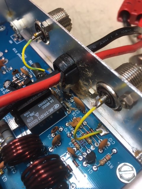

I have a Bulletproof amplifier with two 1446 finals, I think it was called Bulletproof One. Power is way down right now and it looks like something under the power cord blew. You can see all the stuff blown all over. Does anyone have an amp like this that can look and see what part it is that let loose? Thanks.

Is there any chance that someone connected the red and black power wires backwards?
The brown schmoo is most likely the brown kraft paper that used to be on the inside an electrolytic capacitor. Reverse polarity is a popular way to explode this kind of component like we see in the pic.
If the power is down, it's most likely that you have one or two damaged RF power transistors. Have a very close look at the input side of those transistors. A resistor that looks burned or darkened attached to that end of a RF transistor indicates a bad one.

The amp has an Anderson quick-disconnect you can see in the pic. I run this amp on SSB with either a Uniden Madison doing 15-17 watts PEP or my Delta Force dialed back to 12-14 watts. It's been a superb amp for the last 10 years, I would run it on med or hi and get 100-130 out of it. I hope the finals are ok but they can be bought from RFparts still for a steep price. Wanting to see if someone has the value for the blown part in the pic.
