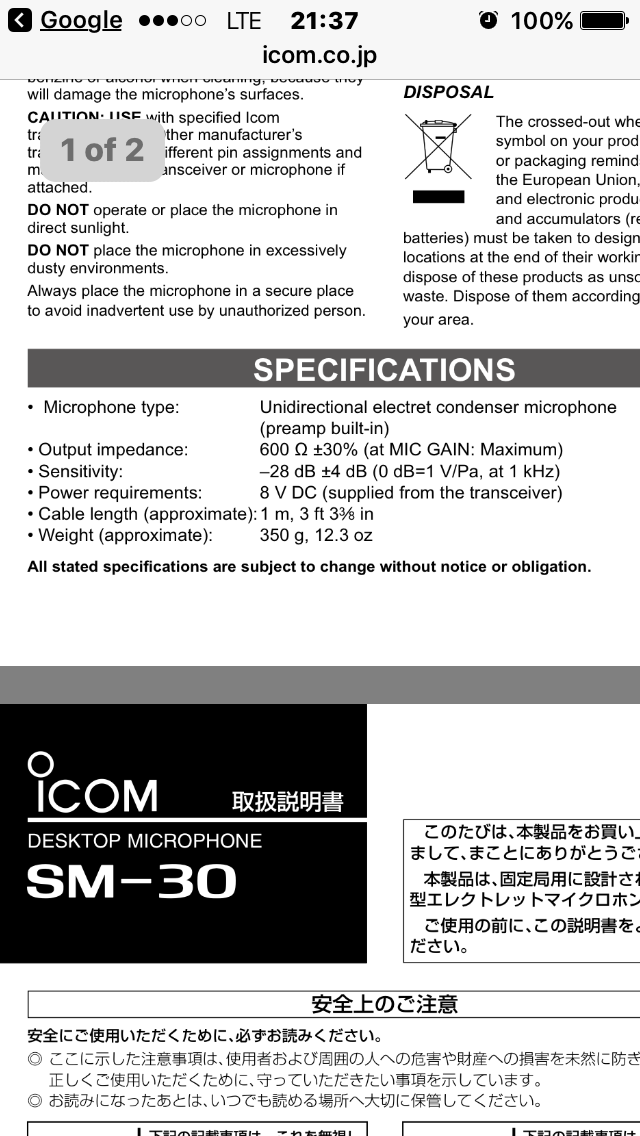

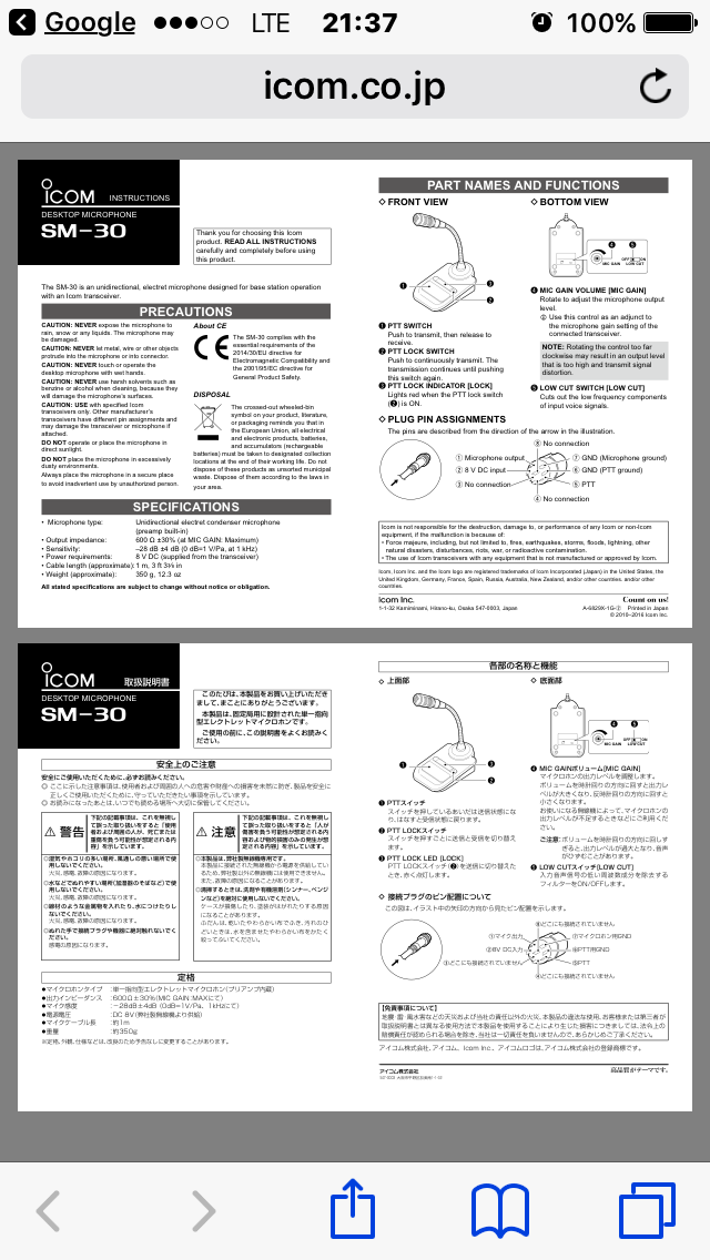

Thanks TBA, I have a Icom 720a that is missing a mic. I looked up on the Icom site what mic matches with what rig. For mine it has Hm7 , SM 5 , SM8.But it did not have the SM 30 on the list . I was told that a SM 30 would work fine. Id just like to be certain before I buy a new SM 30, that it will work . And basically be able to look at all 3 specifications and compare

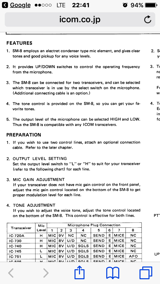

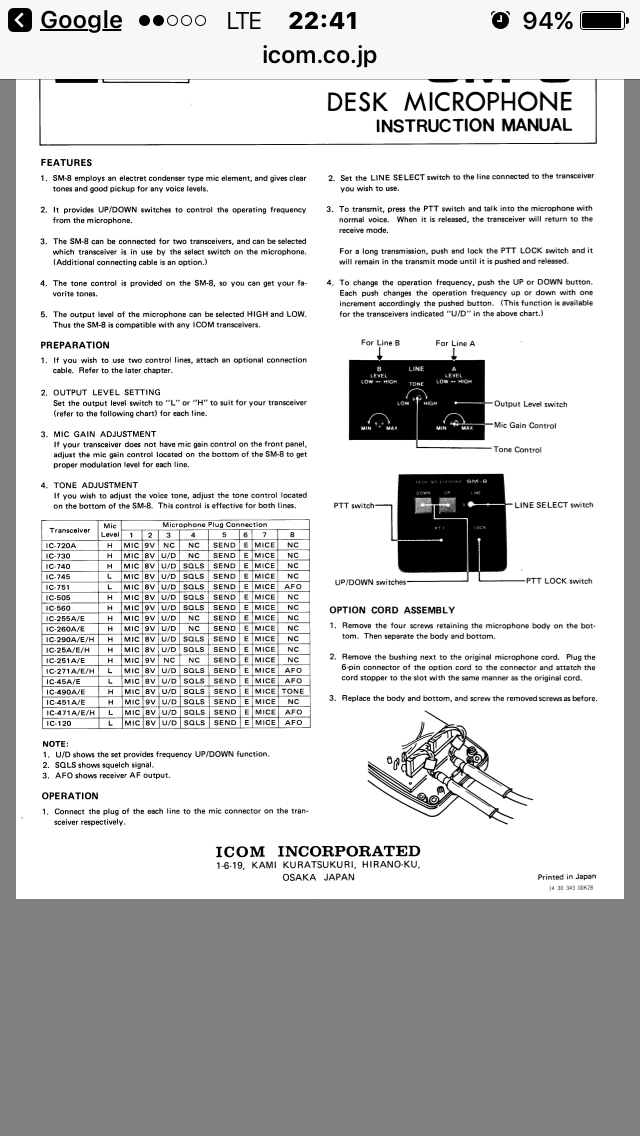

From the SM8 manual.
Read line 5 of the pic below. States the SM8 mic can work with all Icom radios due to the high/Low output switch.
The SM-30 should work jusr fine. I've found that most Icom mics are compatible with other radios from Icom. As long as it's the same mic element and the same impedance, I would think it would work just fine.
