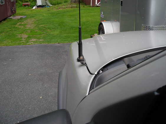

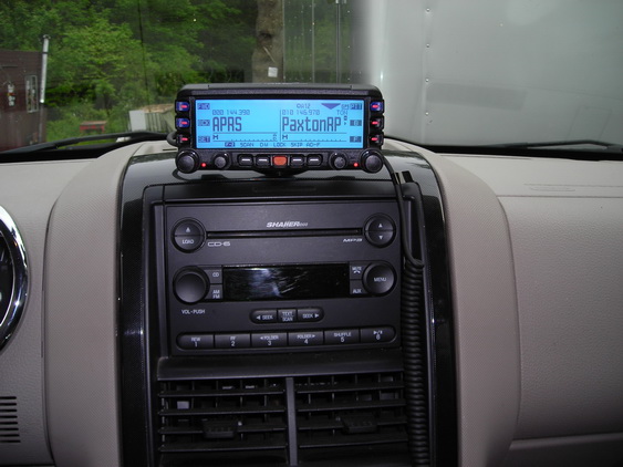

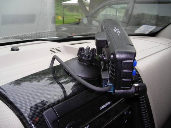

Here is the Install for my 2006 Ford Explorer, the suction cup really worked out well.
