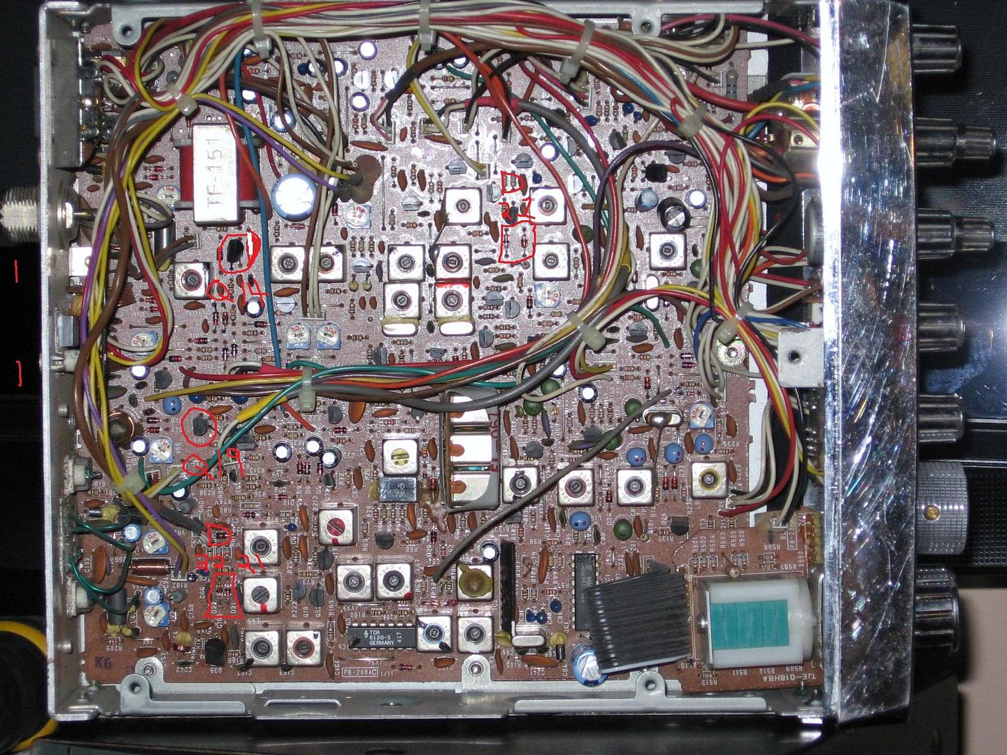

Take a look at the component side of the radio and find the positions outlined below. They are TR-14*, TR-19*, D1, D2, D21, And D22. These areas are where we will be working. Also take note of the orientation of the transistors (TR’s) and note that the flat side faces the rear of the radio, It is important that the new parts be installed the same way, The same holds true for the Diodes (D’s) as the stripe must be facing the correct side on the new diodes.
I like to start with the transistor at position TR-14, this is the Am Detector. You need to unsolder this from the backside of the board; it’s easy to find its location on the rear by holding the radio up to a bright light and using a pen to mark one of the legs. Make sure it’s a pen and not a pencil. Once you have the Transistor lose, you can place it aside as you will be using it again in a second. Place the new 2sc2999 transistor in the TR-14 position with the flat side facing the rear of the radio. Flip the radio over and solder each leg. Heat the joint for 2-3 seconds before applying solder. A good joint is shiny joint not dull and grey. If it is you need to heat the joint longer.
Move over to the Transistor at TR-19 and remove it. Take the Transistor you removed from the TR-14 position and solder it in place, Again the flat side will face the rear of the radio. This is the ssb detector.
You can now replace the diodes at D1, D2, D21, and D22 with the new 1N6263 diodes. These are low noise diodes that help quiet the natural hiss of the radio. The bands on the D1 and D21 diodes will face towards the mic connector, the bands on the D2 and D22 diodes will face away from the mic connector.
