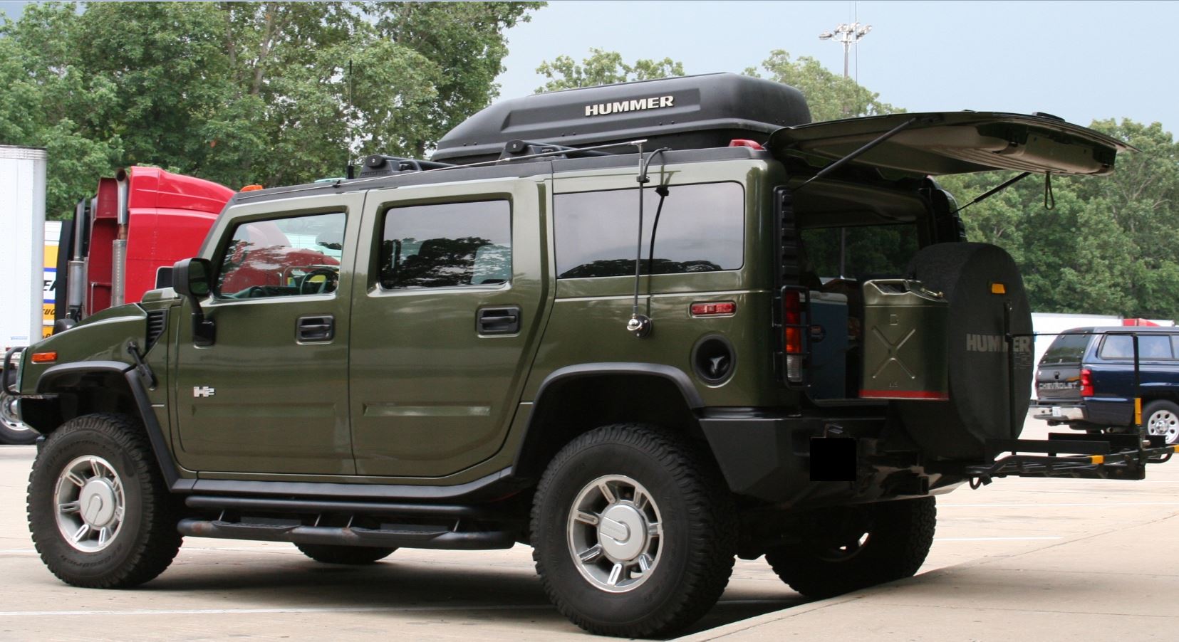

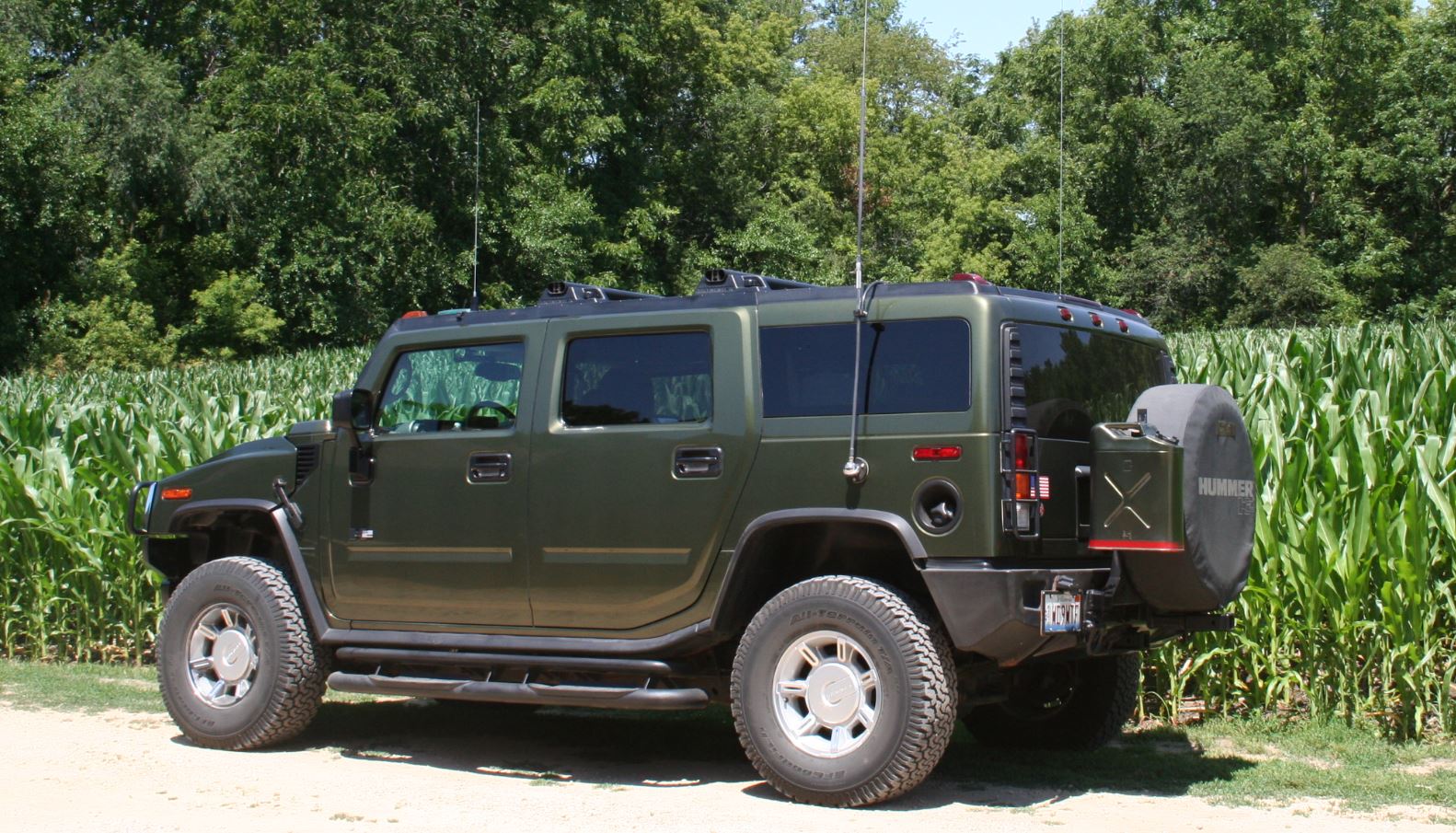

What works real well is the " Fold Down " 110 inch whip.
made with a Hustler Folding Shaft and a cut down stainless steel whip.
(that's what the loop body brace is for) the SWR stays at 1.3 to 1.5 at max
power out. Thread in different whip lengths for freqs you need to work...

It,s not 102, it,s 110 inch for 10 and 11 meters. there is a 1.6 on 11m with a 2kw dead key.
the antenna works well. it seems to favor the larger diameter aluminum shaft loading into
the more tapered stainless steel whip. it makes a really nice taper form the mounting ball
to the tip of the whip. the stainless steel whip can be replaced with different lengths ,
for Freq's you want to work....
