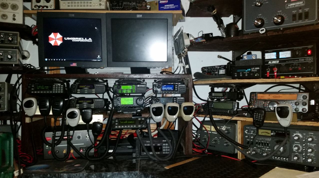

    This is my mid 90's Motorola Spectra converted to 2m. This is the 110w trunk mount with the system 9000 control head. I use it as a base station with a Diamond X50 antenna. These radios are built like tanks and can't be beat, especially in a metro area. They are dirt cheap on eBay. Only problem is most will need to be recapped, but not a big deal.

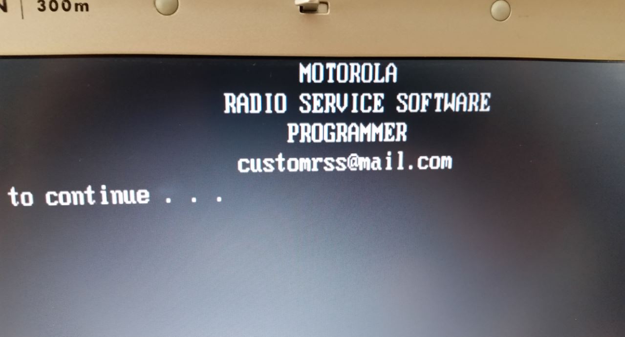

    I always wondered what it was like to program one of those.
  4. KD8HMO
    KD8HMO
    Expand Collapse
    Sr. Member
    Joined:
    Aug 3, 2008
    Messages:
    120
    Likes Received:
    48

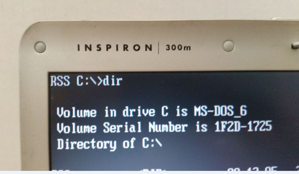

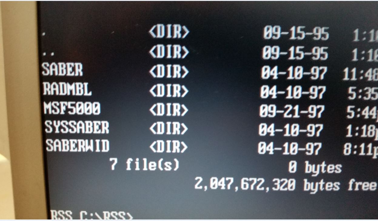

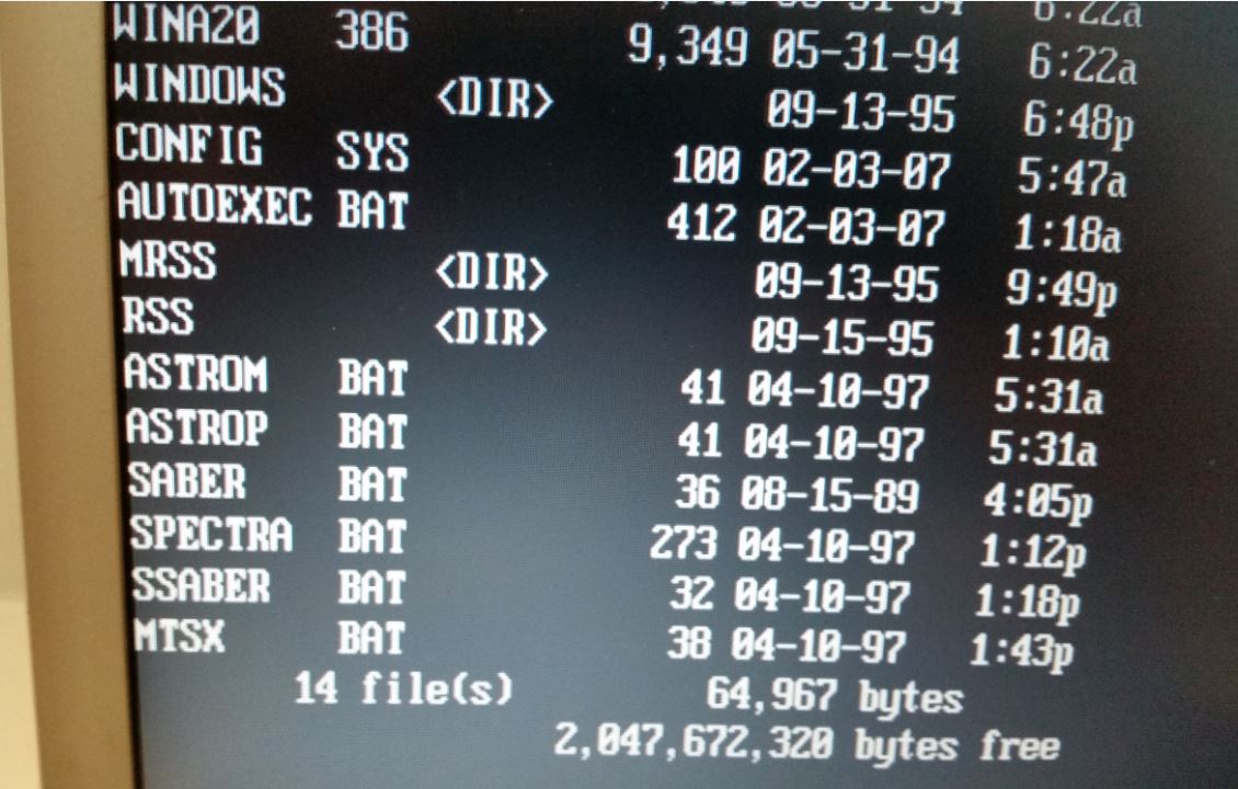

    You have to have a special interface box and cable. You can buy a cable with the box internals built in now. It's not too hard for basic programming.
  5. KD8HMO
    KD8HMO
    Expand Collapse
    Sr. Member
    Joined:
    Aug 3, 2008
    Messages:
    120
    Likes Received:
    48
    First thing you do after connecting the radio to your pc is start the software and download a copy of the radios "code plug" programming file. Then put a copy of it somewhere safe, in case you brick the radio. Then you modify another copy with the software and upload it back into the radio. Basically the same procedure as my VX-7R using a computer.

    I'm using the black, L shaped Motorola desk mic with this. I get constant compliments on how it sounds.
