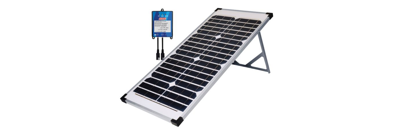

    That's one of the reasons photovoltaic has not taken off.($$$$$$) When you are camping do you have your vehicle with you? Or are you one of those that will back pack into the wilderness?
    If you have your vehicle the link below is the most affordable I could find.
    https://www.harborfreight.com/catal...,EAFeatured+Weight,f,Sale+Rank,f&q=solar+cell

    Mudfoot,
    The Harbor Freight twin panel is about the best price you will find. No matter the brand, my experience is that Mother Nature married Murphy and you never get the rated wattage from a solar panel. Figure about 90 watts fleeting and about 70 constant. It will vary minute by minute. Don't let your battery fall below 10.5 volts or you'll kill it. Depending on load and duty cycle you can actually run all day using a CB radio. Even a 20-amp ham rig is good all day if you take a break and have a beer. If you hit the battery with a constant high load, say 20 amps, then figure about 3-hours till you're charging for 4.
