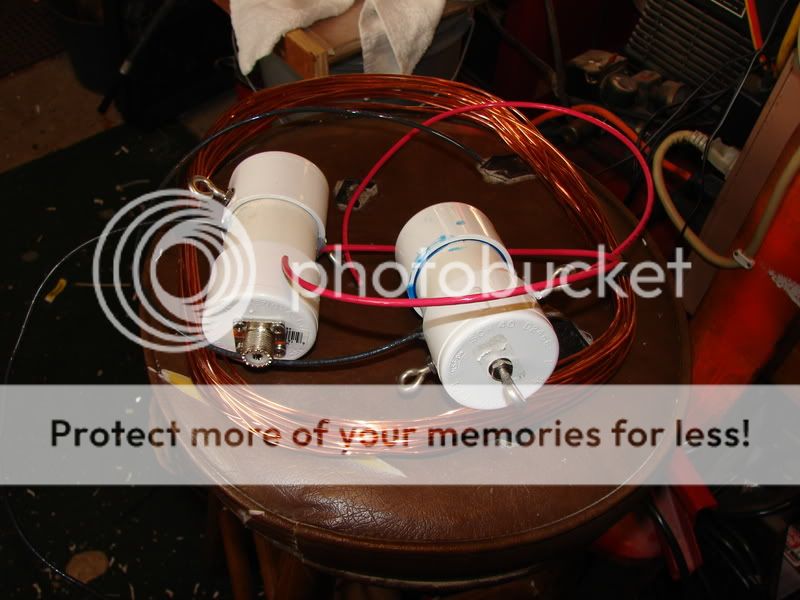

This morning while listening to the Rotten Apple Crew net on 40 meters, I constructed a new 20 meter dipole using one of the support fixtures I made up yesterday......
I just hope the Bomb Squad doesn't see it, they're liable to shoot it down out of the tree......
Some of the other issues I corrected with the New and Improved version was the use of heavier stranded wire that I gutted from 10 gauge extension cord, PVC pipe insulators on the ends, then my bungie cord shock absorbers, and I also lowered it about a foot, this allowed me to straighten it out from a deep inverted "V", to a slightly shallower inversion, and created better clearance to a few wild tree branches that were making contact whenever a breeze was blowing.
Now my SWR's are back down to a 1.2:1 and I'm getting better output signal strength as well.......
