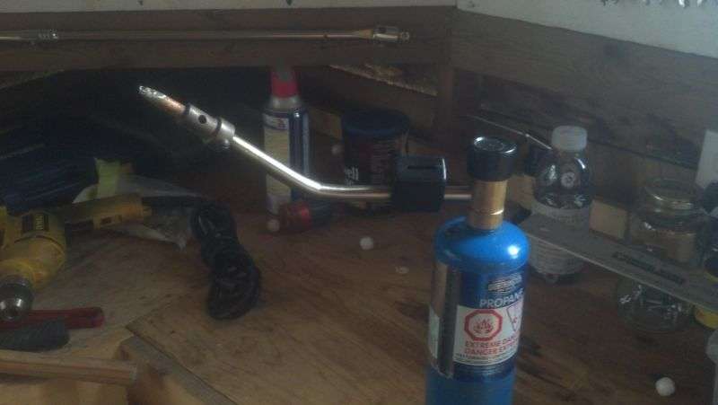

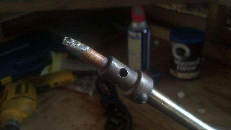

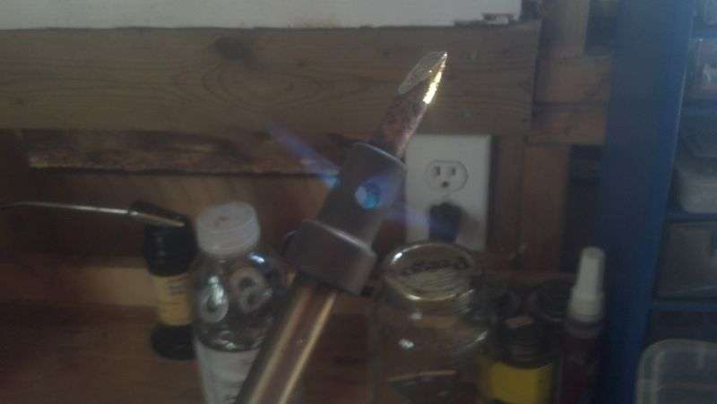

    Every now and then the subject comes up of the proper way to solder a coax connector or heavy ground wires etc. In the past I have mentioned about soldering copper flashing etc also. I have mentioned about using a solder tip made to fit a propane torch and a lot of folks have never heard of such a thing. I tried to find an image on the net to post several times and came up empty. I have since looked in the hardware stores and again came up empty. Apparently these are a thing of the past I guess. Last week I was cleaning up my shop and low and behold I found it. this will fit the regular size propane torch head as well as the smaller "Spitfire" heads which I have it mounted to in the images below. It takes about 45 seconds to go from cold start up to melting solder. Not sure what the wattage equivalent it would be but any electric iron would be hard pressed to even try and keep up with it. It even works on LARGE copper sheets. Once you get started it just keeps going and going and going and goi......

    I had one of those before my move last year, works great. Just have to ensure you keep your body parts away from the flame ports. It only takes once to find out why.:oops:

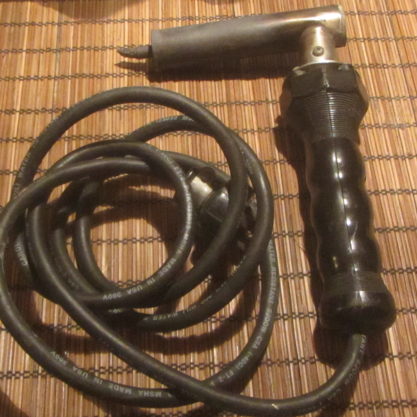

    Bought this for $2.00 at a garage sale many years ago. The cord on it was shot so I replaced it and it's worked ever since. Made by Wall Mfg of Grove City PA. 315 Watts. It will solder a coax connector in a heartbeat.

    I've never seen one quite like that. I like the 90 degree angle it has.

    The right angle makes it very easy to use, CK. The discoloration on the heater barrel is because it glows red when it's fully heated.

    Holy Balls!! That looks like a devastating mishap waiting to happen!! LMA:LOL:!!
