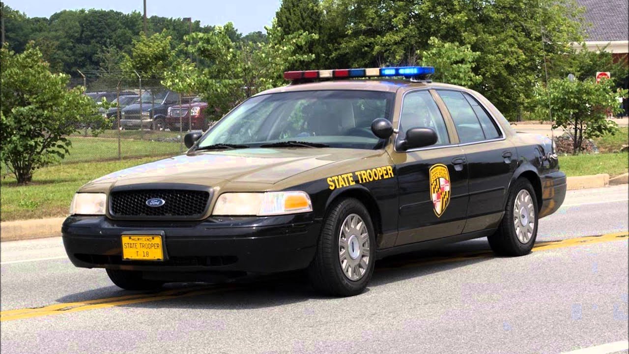

Saw what appeared to be a 102" whip on the MSP car the other day while passing thru. Didn't know they still ran them.
File photo:
