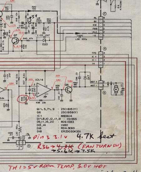

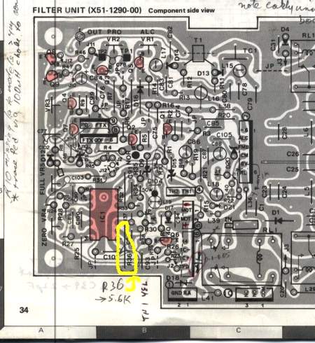

    Changing R36 to a higher value will cause the TS-430S fan to turn on at a lower heat sink temperature.
    Remove PA module, unplug connectors on filter unit, remove filter unit, replace R36 with 4.7k. use of a higher value may cause the fan to turn on at room temp (i.e., run all the time).
    Mod Provided by K0ZL
