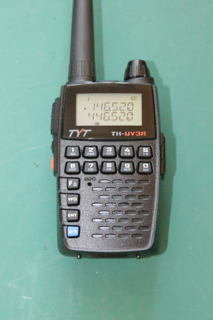

    The first thing that is noticeably different about this little 2.5 watt radio is the keypad for direct frequency entry, which is what compelled me to try out this competitor to the Baofeng.

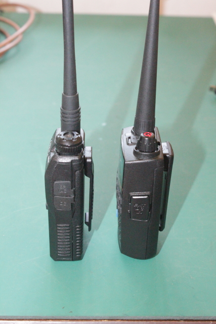

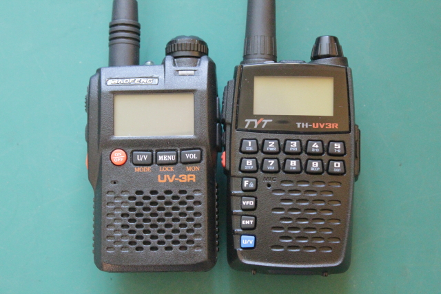

    For size comparison, here is the TYT UV-3R next to the Baofeng UV-3R:
    [​IMG]
    Although the height and width are virtually the same, the TYT is actually a little thicker, as shown in this picture:
    [​IMG]

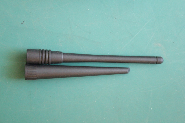

    The other physical difference is the size of the included antenna. The TYT is a bit smaller:

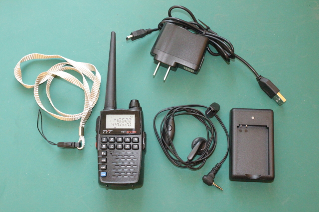

    Like most of the Chinese radios, they include a belt clip (not shown below), a hand strap, charger, and earphone / mic.
    [​IMG]

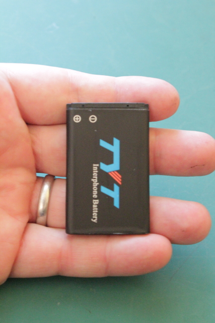

    The battery is a very slim 3.7v 1300mAh battery commonly found in digital cameras:
    [​IMG]
    If you would like to purchase extra batteries, they can be easily found on ebay for about $3!

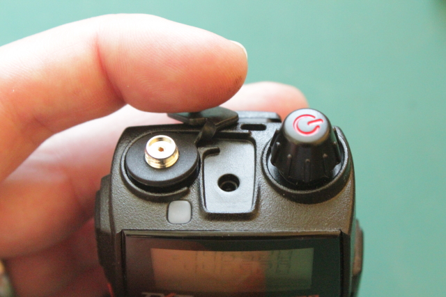

    First, it uses a standard SMA connector for the antenna. The Speaker/Mic plug on top uses a smaller 2.5mm stereo jack, which is also used to program the radio via computer. This is a smaller connector than most other radios, so you might need to find an adapter or roll your own cables.
    [​IMG]
    The top right knob functions as the ON/OFF and frequency UP/DOWN.

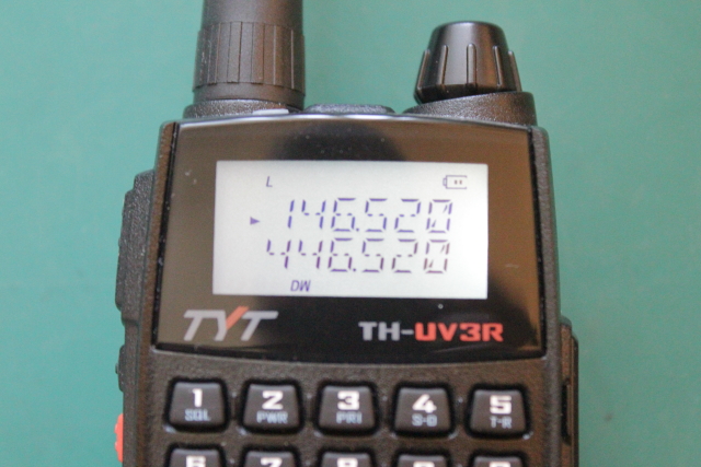

    The display is a very clear (although this picture is slightly out of focus) LCD that is actually quite nice:
    [​IMG]

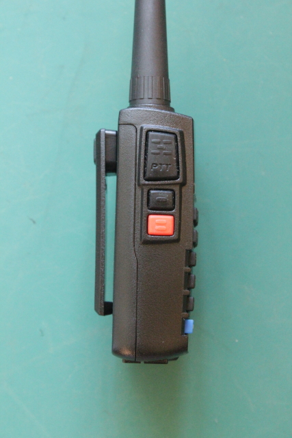

    This display is also much more durable than the Baofeng and will take a bit of a beating. The left side of the radio has the standard PTT, a Monitor button, and an orange alarm button that causes the radio to transmit a high pitched alarm when pressed:

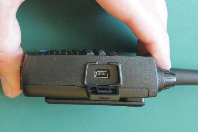

    The only thing on the right side of the radio is the USB battery charging port. This USB port is only for power; you cannot program the radio with a USB cable. However, since it is a standard USB power connection, you can charge it from a PC or any other device that provides USB power to the cable.
    [​IMG]

    I want to first stress that this radio is incredibly easy to use compared to some of the other Chinese HTs.

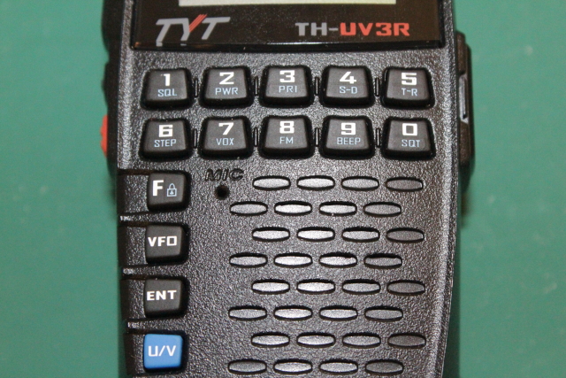

    Take a look at the keypad layout and button descriptions:
    [​IMG]
    The first thing you'll notice is that nearly all of the functions are easily understandable. To change frequencies, you either rotate the dial on top or just start punching in the frequency using the numbers. The blue U/V button toggles between the upper and lower VFO. Although the button is labelled U/V, you can actually use the VFOs for U/V, V/U, V/V, and U/U.
    The VFO button toggles between memory mode and VFO mode. Accessing the functions associated with the numbers is as simple as hitting the F(unction) button first, as expected.
    The first thing I always do with any new HT is to attempt to figure out as much as I can without reading the manual. On this radio, I figured out nearly ALL of the functions, with the exception of adjusting the volume and how to work with CTCSS and DCS codes.
    The tip for adjusting the volume is to hold the monitor button on the side (below the PTT) and turn the knob on top.
    More to follow...

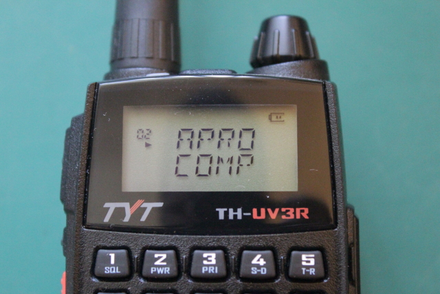

    Another interesting feature is the "Voice Mode":
    [​IMG]
    This setting affects how your TX audio sounds. The default setting is "OFF", which is what you would normally use. If you select COMP setting, it activates the "compander". This is like turning the Mic gain way up. When I tried this with other simplex stations, they liked this turned on, but when I went through repeaters, stations usually said that it caused the audio to be borderline hot. If you choose SCRM, it activates the "voice scrambler". I'm not sure exactly what this mode does, but it sounds like it removes the carrier from the FM. You can actually barely understand the transmission on FM and it's fairly easy to understand on SSB.
