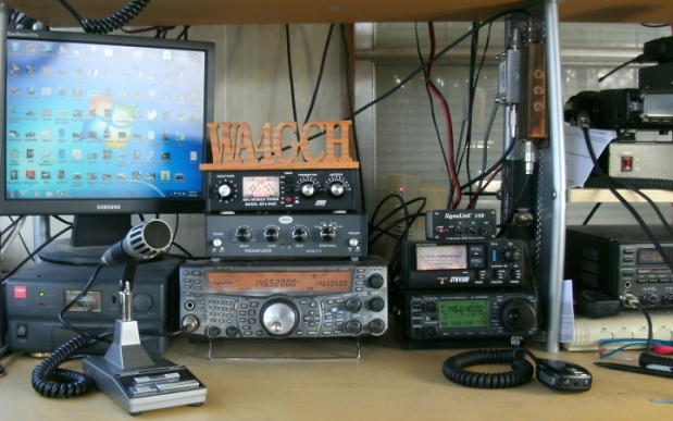

    I have owned Yaesu for more than 35 years ..... The ONLY one I would not recomend is the FT-100d.....
    The 857 is fine not much i can say bad about it unless you have bad eyes like me then the small size is as problem.
    It is a very good radio not contest grade but you don't need that .....
