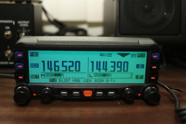

    In the above screens, you can see that I have selected the APRS functions for the buttons across the bottom. You do this by pressing the right "F" button repeatedly until the menu at the bottom reads "F-3".
    In this picture, I've hit the S-LIST, or Station List button to show all of the received APRS stations:

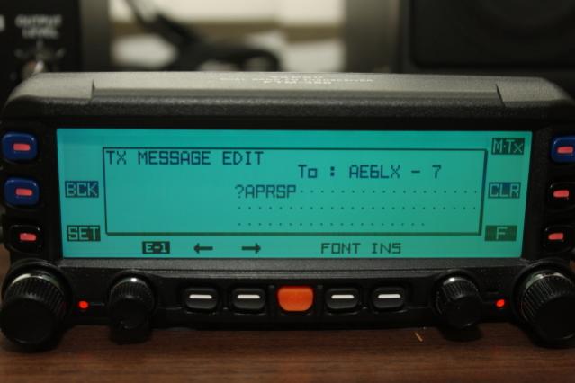

    If you choose any of the Reply or message transmit buttons, you get this screen:
    [​IMG]
    To input the message, you can use the soft buttons on the bottom of the control head or just use the DTMF mic to input the message in the same way you would enter a text message on your cell phone. On the DTMF mic, you can also use the A or B buttons to move the cursor, as well as the C button to delete. The instructions in the manual are pretty clear on this topic.

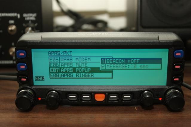

    APRS Popup
    You can choose how the radio notifies you of other stations and messages. The default is to popup a screen on every received beacon and message. In a busy area like Southern California, I don't want to be notified of every station because there are too many of them, so I turned the beacon off. You can also set a time limit that the popup screen displays for both the beacon and message.

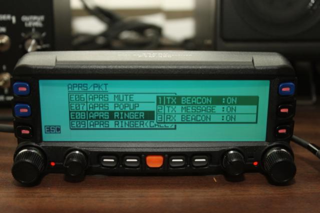

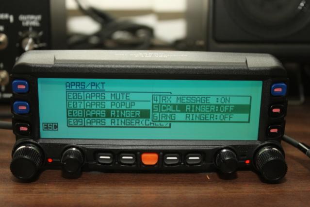

    APRS Ringer
    The radio also gives you a little bell ringer when it receives or transmits a beacon or message. You have complete control over this behavior, as well:

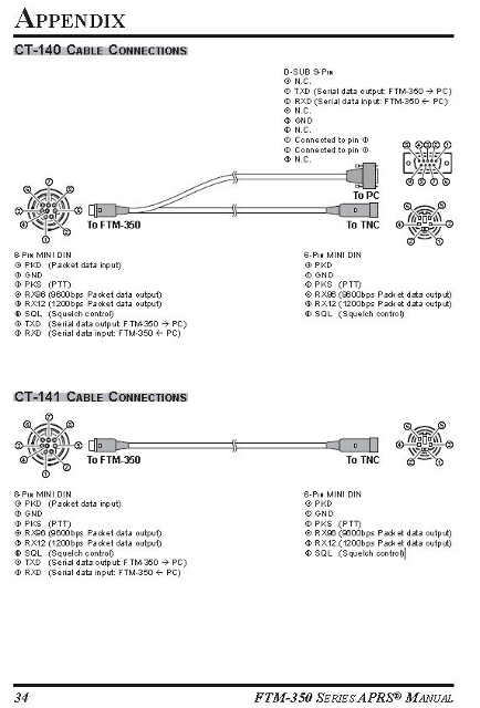

    Yes, you can do that. Here is the interface details from the manual:
    [​IMG]
    The cable isn't available yet, but you could make your own, easy enough. Still, it seems like a waste to have to go through this to digipeat when the radio understands how to do everything else APRS related. It doesn't seem like it would be that much extra programming to provide a digipeat option.

    Molecule, from that manual page it looks like the the FT-350 plugs into an external TNC as well as a computer. Do you think it would be happy just connecting its internal TNC to a computer?

    The manual is VERY sketchy on the data functions of the radio. In fact, the manual has nothing on this topic except how to select the data VFO and set data squelch! The set menu shows that you can choose to output either GPS or packet data to the COM port, so I take that to mean that it will definately output APRS (packet) data. It doesn't say anything about having to turn off the APRS modem to do this. In fact, it DOES say that you can use the same VFO for both APRS and Packet TX/RX, so I take that as a good sign that you can use both the internal APRS functions and those of an external TNC at the same time. This will be something interesting to explore when I either make or buy a cable.
    See the above paragraph. It certainly looks to me like it will output packet data to the computer. You would still need some software or a TNC to do something useful with it at that point.
