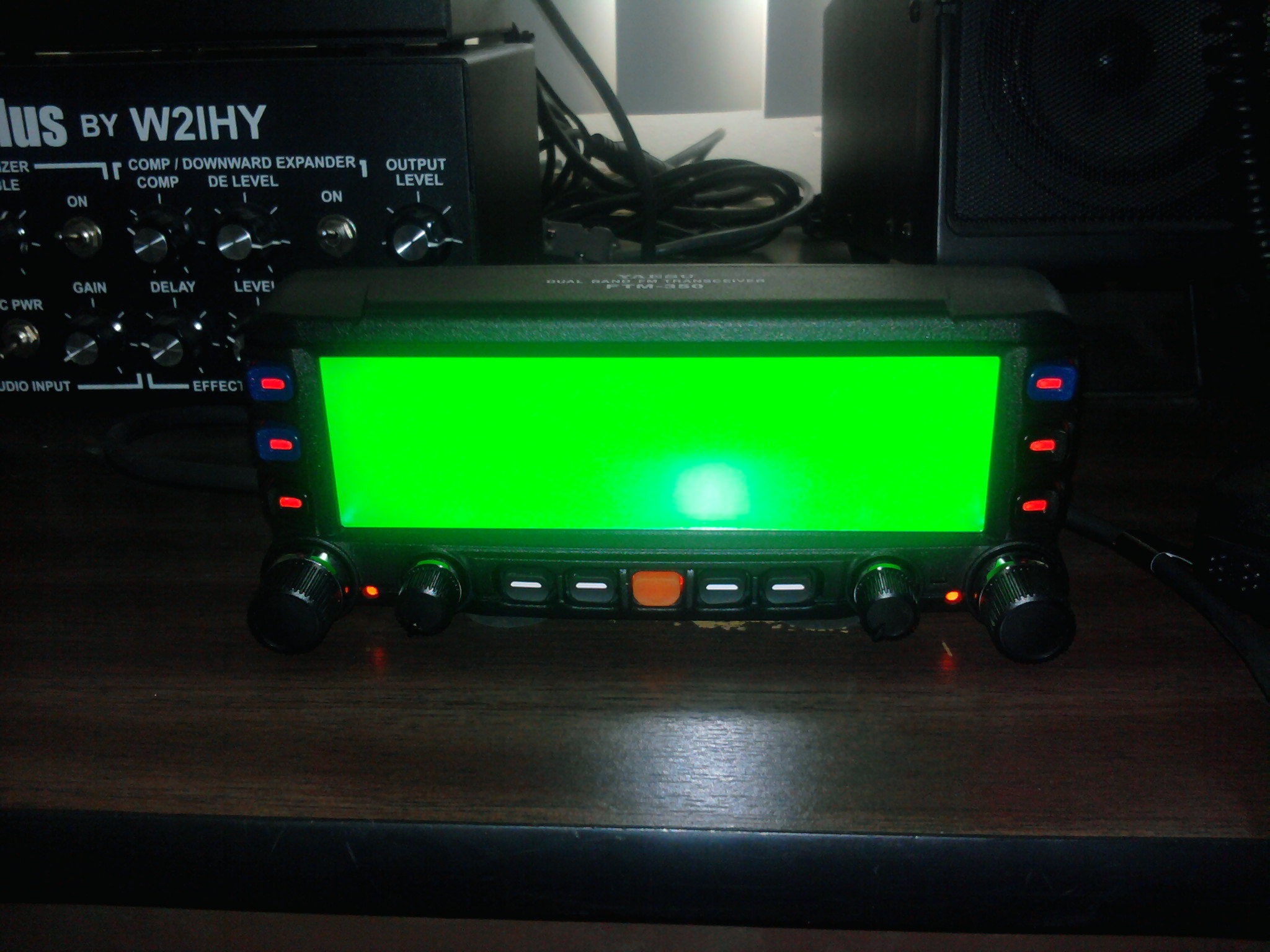

That's usually how it looks for me, too. However, I had a different one last night. I've seen this type of lockup one time before also. Here's a pic:
