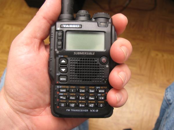

    Here is a picture of the new little HT:
    [​IMG]
    You can see that it fits pretty well in the hand. It's not too small to the point where the buttons are difficult, but not so large to be bulky.

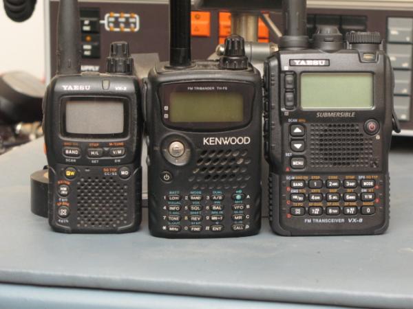

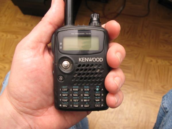

    Here is a comparison in size to the popular Kenwood TH-F6a and the ultra small Yaesu VX-2r:
    [​IMG]
    [​IMG]

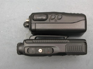

    Here is a picture of all three radios side by side for size comparison purposes:
    [​IMG]
    Even though the VX-8r is a little larger in height and width, you can see from this picture that it is more slender:

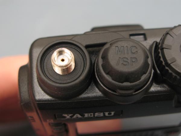

    Here is a picture of the SMA antenna connector. You can see that it has a thick rubber seal that mates with the rubber around the antenna. The lip of the seal extends up to help keep water out. Very nice.

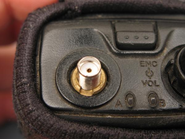

    Here's the THF-6a connector for comparison. Its seal is inside the radio. Of course, Kenwood doesn't claim that the TH-F6a is waterproof, either:
    [​IMG]

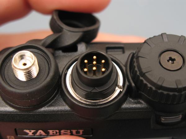

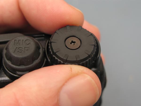

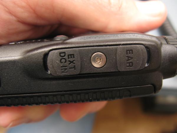

    Here is the external mic connector with the waterproof cover popped open. When you attach the connector, the plug presses in, then scews on. This is similar to how commercial handheld radios are built. Maybe this is some of Motorola's influence starting to show? Regardless, it's a really good design (y)
    [​IMG]

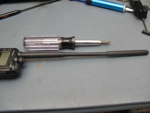

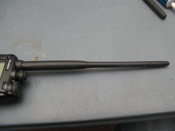

    Here are a couple of pictures of the antennas. The first is the stock antenna for 50/144/220/440 mhz. The second picture is with the low frequency extender added. You can use it like this at all times if you want, but you can see how much additional bulk and length it adds. The manual says this extension greatly improves reception below 50mhz. I'll guess we'll have to find out after it finishes charging up.
    [​IMG]
    [​IMG]

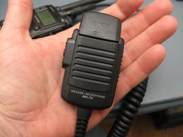

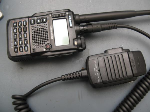

    Here's the external speaker/mic with the optional GPS receiver installed in the top. The GPS receiver is also held in with a screw instead of just snapping in. I think this is a pretty nice sized speaker/mic also...not to small, but not too big.
    [​IMG]

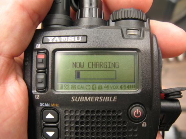

    That battery is shipped deader than dead, so I'll probably have to wait until tomorrow to play with the radio. While it's charging, you can see how nice the dot-matrix display is with the charging progress bar showing:
    [​IMG]

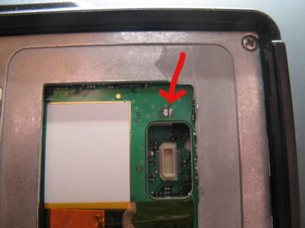

    Since I confirmed everything was working as designed, I decided it was time to mod it for out of band TX. Keep in mind that I'm a MARS op, and I need this.
    I emailed Yaesu on Friday for the info, but I hadn't heard back yet. I was impatient, so I figured I would see if I could figure it out myself :D :unsure: :D
    Here's how to do it:
    -Take out the battery.

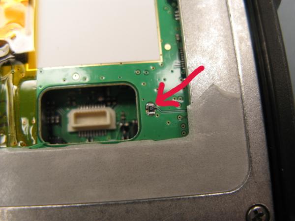

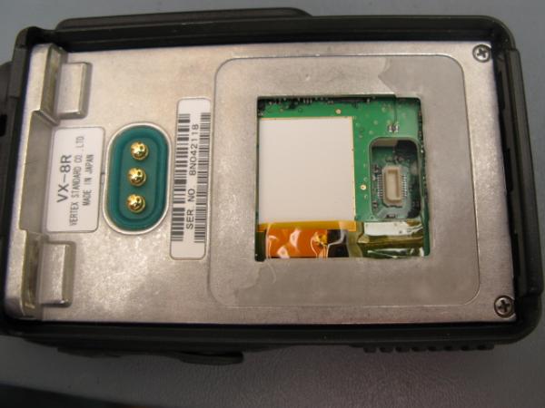

    -Under the battery is a heavy, thick plastic cover with very strong adhesive. Remove it using an XActo knife or a very small screwdriver that you can slip under it. This is the same cover you need to lift to install the Bluetooth option.
    -After you get the cover open, it will look like this:
    [​IMG]
    To mod the radio for out of band TX, locate the only resistor visible on the board, just to the left of the bluetooth plug:
    [​IMG]
    All you have to do is carefully remove this resistor. I have a fine tip for my solder station for little work like this:
    [​IMG]
    Make sure you clean off ALL the residual adhesive. Don't try to put back the cover that you took off, as it will be badly deformed and you will have lost some of the adhesive. Yaesu gives you several extra covers in the bottom of the box, so use a new one. This is important to preserve the waterproof integrity of the radio!
    After you put the battery back in, the radio will have reset and you will lose all of your settings. I'm not sure what the complete range of TX is yet, but this mod definately opened it to TX out of the Amateur bands. I'll cross post this info in the mods section also.

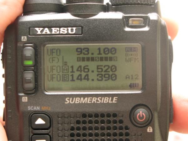

    One neat feature that I just found is that the radio can monitor TWO VFO/Memories on the ham bands while also listening to broadcast AM/FM radio. This is a triple monitor radio! I've never seen an HT that can do this before. If it picks up a TX station on one of the vhf/uhf frequencies you're monitoring, it mutes the audio of the AM/FM broadcast briefly so you can hear the VHF/UHF station. The default mute is 2 seconds, but You can adjust it to whatever you want. You can even scan on the VFO's while listening to broadcast AM/FM! If you want to TX, you just key the radio and it will TX on whichever VFO button is selected. This is a very cool feature!
    Here's a pic of the radio showing broadcast 93.1 FM while monitoring 146.52 and TX/RX'ing local APRS data simultaneously on 144.390. You can see that the VFO A button is activated (just to the left of the display) so if I key the radio, it will TX on 146.52.
