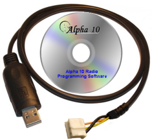

This radio can be programed by software.
You will need the software and USB cable kit

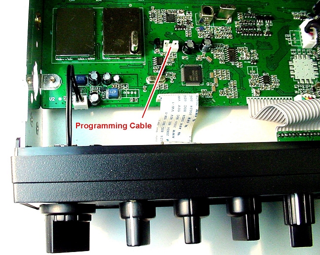

Remove the bottom cover and plug the cable in the connector shown in the picture.

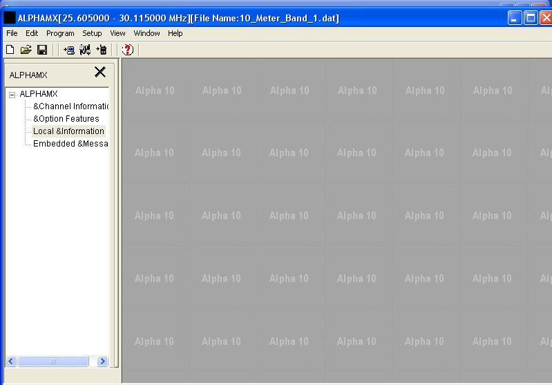

When you startup the programing software there is a short splash screen with the Alpha Logo.

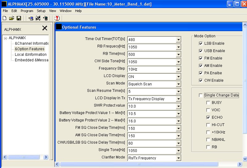

Click on Opition Features to set options

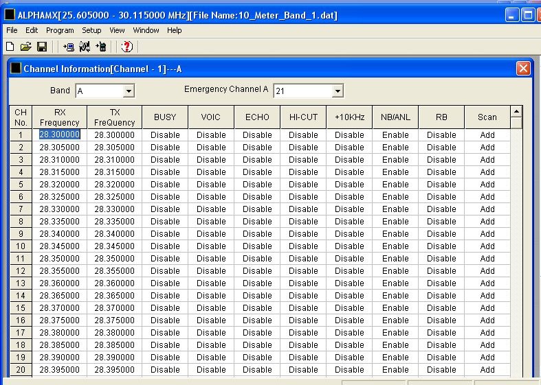

Click on Channel Information to program channels.
After you get everything set the way you want it download to radio.
