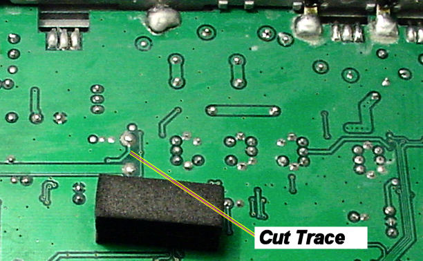

Modulation Limiter: Not Recommended
* Carefully Cut the small trace on the PC Board (Bottom Side) shown in the picture.
