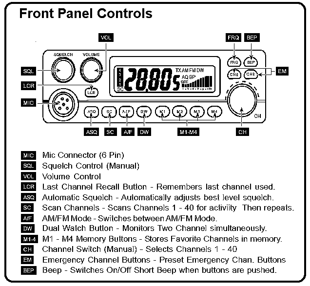

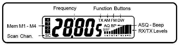

Another outstanding feature is the large orange backlit display that not only displays the frequency, it will also display the channel number with band letter! The unique looking woodgrain front panel is different from other units, and loaded with buttons and features that are normally found on more expensive radios.
Front Panel Features include:
Automatic Noise Filter/Blanker
Last Channel Recall
Dual Watch
Automatic Squelch
Channel Scan
Emergency CH Buttons
Channel/Band/Frequency Display
Digital Signal Meter
Backlit Buttons
CH Up/Dn Buttons on microphone
AM/FM Mode Button
4 Channel Memory Buttons

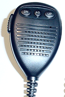

The 6 pin microphone jack may be a negative because I could NOT find any 4 pin to 6 pin adapters that would work on this radio. However, I had no trouble wiring up an old Connex microphone to the first 4 pins using the information from the owners manual (no up/down buttons of course). I wanted to make sure that the microphone was standard, and not like the microphone on the Uniden Pro 510/520! The microphone audio was loud, clear, and may have worked a little better than the factory microphone!
