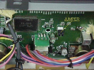

Remove the top cover and look at the circuit board on the back of the faceplate.
2.
On this board you should see two pins SJ3 close to the CPU chip LC7232
3.
Connect a jumer wire between the pins.

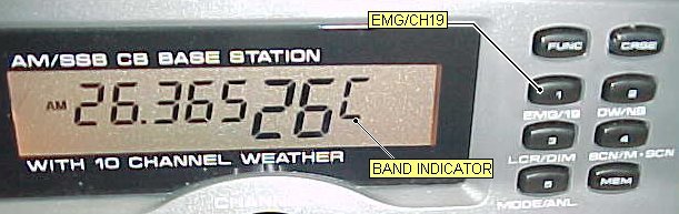

Once the channel modification has been done Power on the unit holding the EMG/CH19 button remember to hold the button for about 5 seconds after power is applied
To change bands just press EMG/ CH19 button. The bands in
expanded mode are displayed near the channel indicator A-J.
