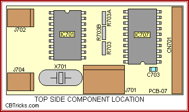

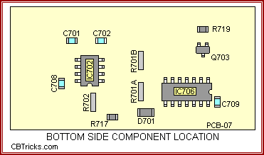

Cherokee
Radios CBS2100
CPU/PLL BOARD ASSEMBLY PCB-07
Parts Allcation
Ref. No. | Description | Ref. No. | Description |
C701 | Chip Cer. Cap CG47pF 50V | J702 | R/A 2pins PCB Header Male Pitch 2 |
C702 | Chip Cer. Cap CG47pF 50V | J704 | R/A 2pins PCB Header Male Pitch 2 |
C703 | Chip Cer. Cap Y 0.1uF 50V | R701A | Chip Net. Res. 5.1K |
C708 | Chip Cer. Cap Y 0.1uF 50V | R701B | Chip Net. Res. 5.1K |
C709 | Chip Cer. Cap Y 0.1uF 50V | R702 | Chip Net. Res. 10K |
Q703 | Chip Transistor KTC3876Y | R703A | Chip Net. Res. 5.1K |
D701 | 1N4148 | R703B | Chip Net. Res. 5.1K |
IC701 | Z86E04 | R703C | Chip Net. Res. 5.1K |
IC702 | HT93LC46-A | R717 | Chip Res. 5.1K |
IC706 | MC74HC164 | R719 | Chip Res. 10K |
IC707 | MC145106 | X701 | Crystal 8.00MHz |
CN701 | Connector Wafer 8 pins | PCB-07 | PCBX-9824 |
J701 | R/A 5pins PCB Header Male Pitch 2 |
