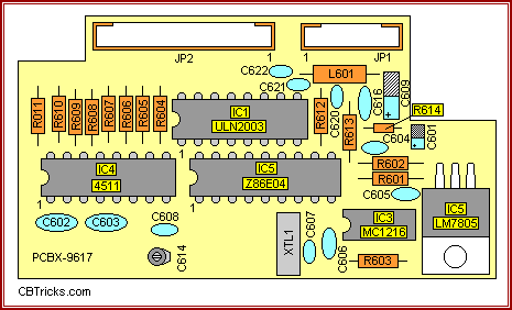

FREQUENCY COUNTER BOARD ASSEMBLY PCB-12
Parts Allcation
Ref. No. | Description | Ref. No. | Description |
C601 | E. Cap. 10uF 50V | L601 | Choke 1000uH |
C602 | Cer. Cap YF 0.1uF 50V | R601 | TJ 10K |
C603 | Cer. Cap YF 0.1uF 50V | R602 | TJ 10K |
C604 | Cer. Cap YB 0.001uF 50V | R603 | TJ 47K |
C605 | Cer. Cap YB 0.001uF 50V | R604 | TJ 100 |
C606 | Cer. Cap YF 0.1uF 50V | R605 | TJ 100 |
C607 | Cer. Cap UJ 47pF 50V | R606 | TJ 100 |
C608 | Cer. Cap UJ 47pF 50V | R607 | TJ 100 |
C609 | E. Cap. 22uF 16V | R608 | TJ 100 |
C614 | Variable VC 20pF 50V | R609 | TJ 100 |
C615 | Cer. Cap UJ 82pF 50V | R610 | TJ 100 |
C620 | Cer. Cap YB 0.001uF 50V | R611 | TJ 180 |
C621 | Cer. Cap YB 0.001uF 50V | R612 | TJ 2.2K |
C622 | Cer. Cap YB 0.001uF 50V | R613 | TJ 2.2K |
IC601 | ULN2003AN | R614 | TJ 1K |
IC602 | Z86E0408 | JP601 | 6pins PCB Header Male Pitch 2.5 |
IC603 | MC12016P | JP602 | 13 Wire assembly Header Female Pitch 2 |
IC604 | MC14511BCP | XTL1 | Crystal 8MHz |
IC605 | LM7805 | PCB-12 | Bare Board PCBX-9617 |
