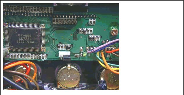

Remove the top cover and look at the circuit board on the back of the faceplate.
2.
Locate the jumper close to the CPU chip LC7232.
3.
Move this jumper off of the pins that it's on and put it on the side.
4.
Once the channel modification has been done press channel 9-19 button and hold and turn on the radio. After this modification use the 1 button to select different bands of 40 channels.
