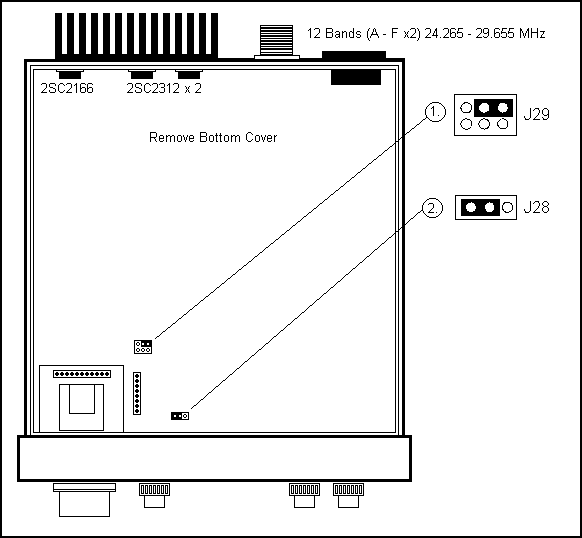

1) Remove the cover from the unit and locate 6 pin jumper labeled J29. Move the shorting block from its current position to the back/right position as shown.
2) Re-assemble the unit and check all bands for proper operation.
