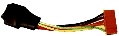

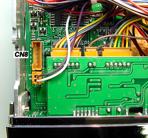

Plug in the module found in the mic box into CN8 (Connector Socket 8)
Temporarily short the pins of JP3 (Just to the right of CN8) while powering the radio on.
This will cause the programming module to write the data into the CPU chip. After programming the radio, the module can be removed or left in place for future use.
