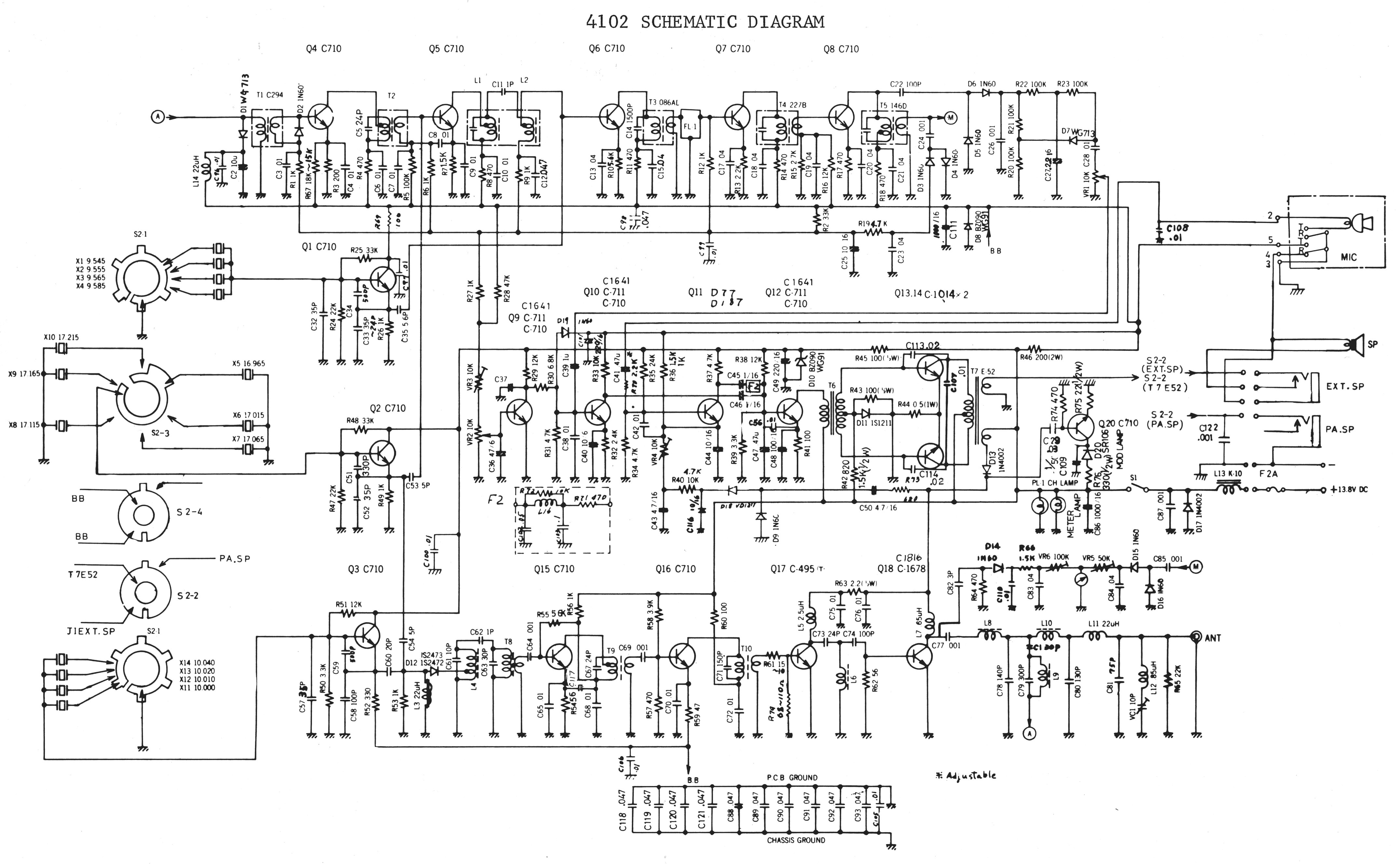

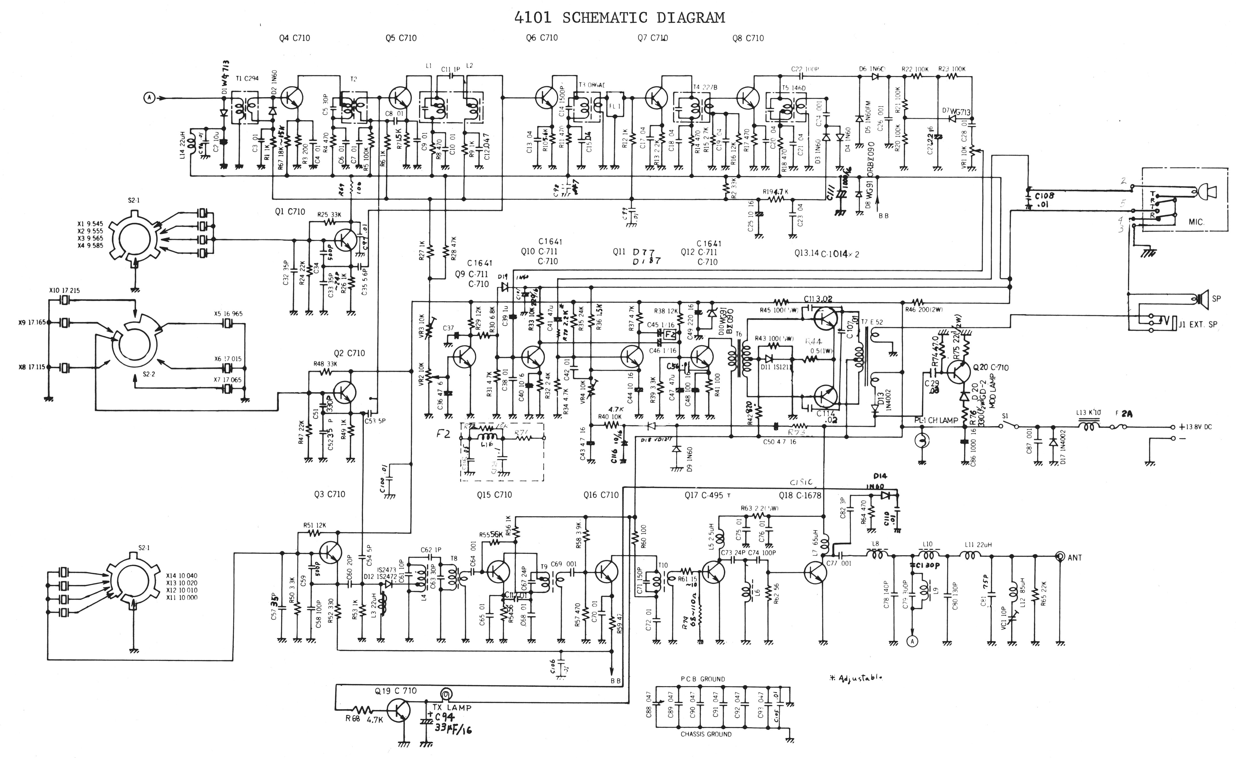

DIAGRAMS (Service Manual)
    4101 Schematic Diagram
    4102 Schematic Diagram

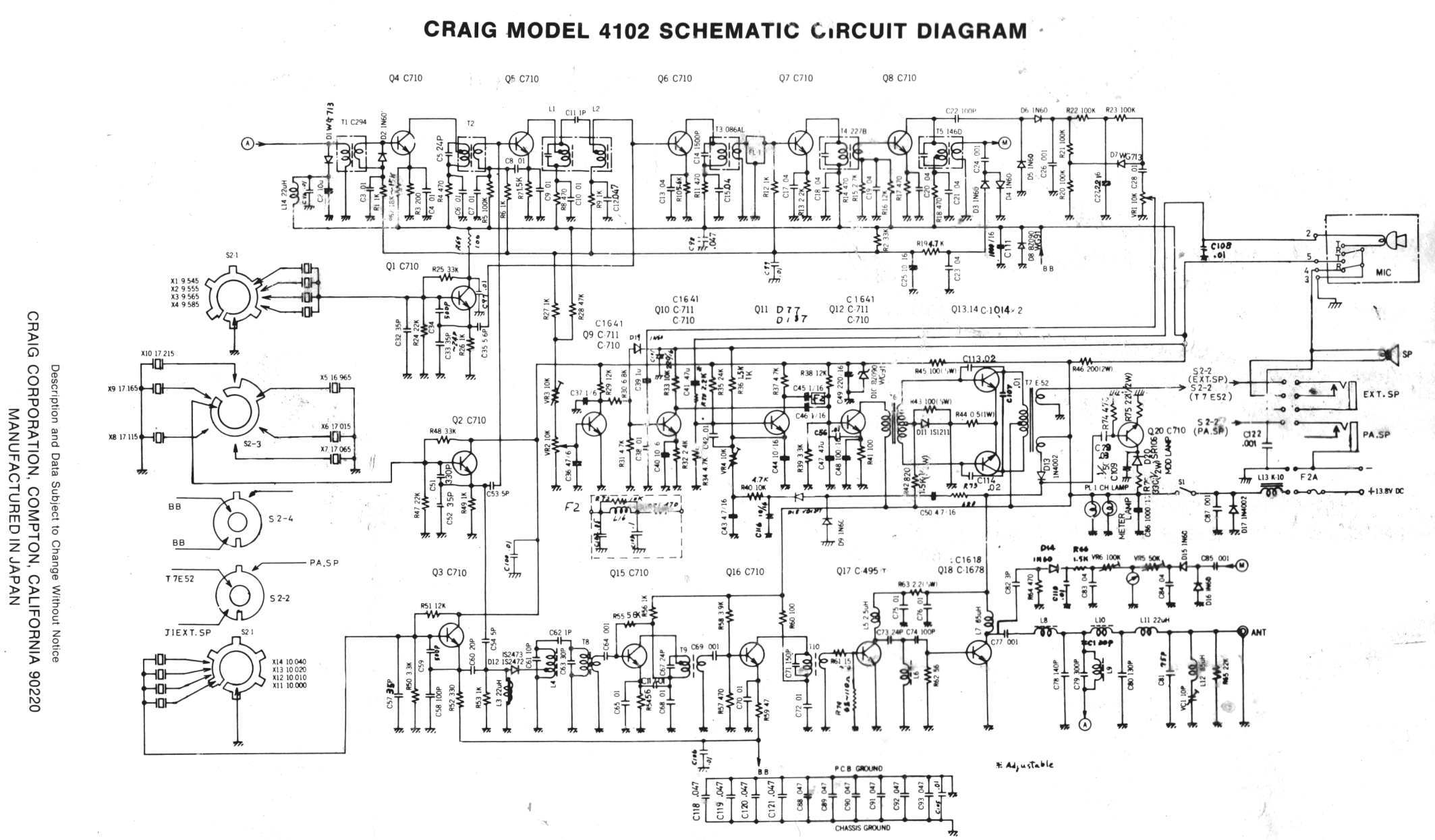

    Craig 4102 Schematic Diagram (Owner's Manual)
