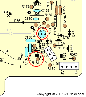

The tone and time of the roger beep on the DX77HML can be changed as follows:
The roger beep tone is controlled by R181 which is 220K ohms:
for a higher tone try 150K to 200K ohms for a lower tone try 270K to 2M ohms
The roger beep time is controlled by C134 which is 2.2uF@16V DC:
for longer time try 5uF or 10uF@16V DC for shorter time try 1uF@16V DC
