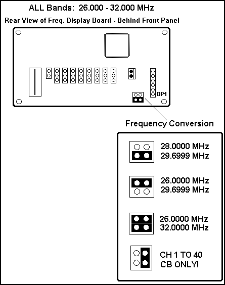

1.
Remove the top cover from the unit and locate the 4 pin jumper block on the frequency display board behind the front panel. Move the shorting block from it's current position to obtain the desired frequency range shown in the chart above.
2.
Once you have the jumper(s) in place, You must reset the microprocessor by turning the power switch Off. The unit will resume the new frequency range as soon as the power switch is turned on again.
