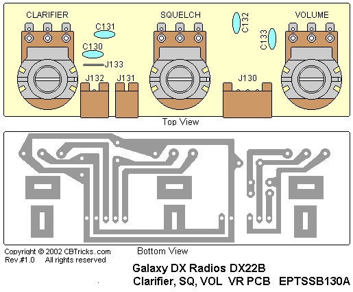

Galaxy DX Radios DX22B
CLARIFIER SQUELCH, VOL. VR PCB(EPTSSB130A)
Ref# Description
MFR. Part No.
CLARIFIER / SQ/ VOL P.C.B. EPTSSB130A
Complete with Components
#T-106D-P11
EPTSSB130A
Capacitors
Ref#
Description
MFR. Part No.
C130
C/C 0.001UF 50W V SL Z
CC0501027L
C131
CC0501027L
C132
CC0501027L
C133
CC0501027L
Potentiometers
Ref#
Description
MFR. Part No.
AF Gain
V/R 50KA
RV50303461
SQ
V/R 50KB
RV50303463
Clarifier
V/R 1KB
RV10203465
Connectors
Ref#
Description
MFR. Part No.
J130
PCB CONNECTOR SOCKET 5P L TYPE
EX07N48497
J131
PCB CONNECTOR/S 2P L TYPE
EX07N48204
J132
PCB CONNECTOR/S 3P L TYPE
EX07N48546
J133
JUMPER WIRE 7x5x7
WX01070705
