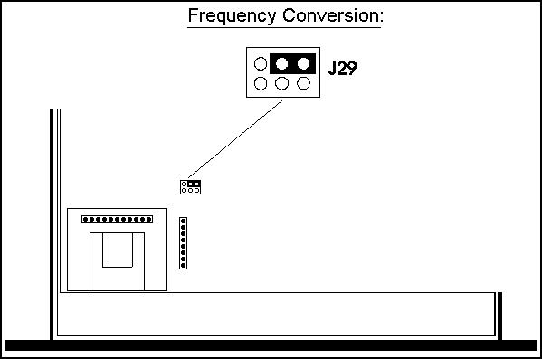

1.
Remove the cover from the unit and locate 6 pin jumper labeled J29. Move the shorting block from it's current position to the back/right position as shown.
2.
Re-Assemble the unit and check All Bands for Proper operation.
NOTE: The Unit ships from the factory with the J29 jumper block on Pins 1 and 2 which works on 28 MHz only.
