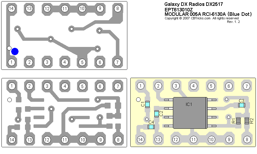

Galaxy
DX Radios DX2517 (MOSFET
Final)
Documentation Project
CBTricks.com
MODULAR
005A RCI-6130A (EPT613010Z)
Schematic
Ref#
Description |
MFR.
Part No.
#T-106S-3��� 001 ����� 001 01(SH5011) |
#F-005A
RCI-6130 PCB 18x10x1.0tmm (d) |
EPT613010Z |
Ref#
Description |
MFR.
Part No.
R1 |
CHIP/F/R (SMD) 22K OHM |
RCY062234Z |
R2 |
RCY062234Z |
Ref#
Description |
MFR.
Part No.
C1 |
CHIP/C 0.001UF 50WV K X7R |
CK1102AD5X |
C2 |
CHIP/C 0.01UF 50WV K X7R |
CK1103AD5X |
C3 |
CK1102AD5X |
C4 |
CHIP/C 100PF 50WV K CH |
CK1101AD5A |
Ref#
Description |
MFR.
Part No.
IC1 |
I.C. (PHILIPS) (SMD) SA602A 8PIN |
YNPH00602A |
Ref#
Description |
MFR.
Part No.
IC PIN 049 |
GZZZ50207Z |
