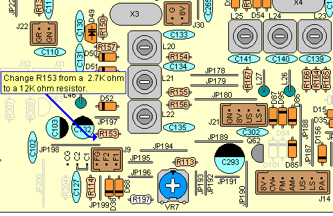

To Increase Clarifier Range:
Locate resistor R153 on the main pc board (grid location G3). It is right next to connector J9 on the front edge of the main pc board and towards the channel selector. Resistor R153 is a 2.7K ohm and can be change to a 12K ohm resistor for more clarifier range. This will give you about 1.2KHz both up and down. After doing this update perform an PLL alignment as shown below.
