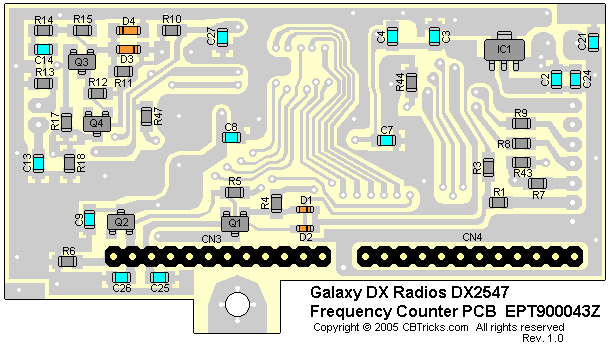

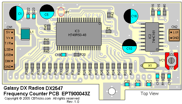

Frequency
Counter PCB (EPT900043Z) (Started with 2005 Production)
Trace
Layout
Schematic Diagram
Ref#
Description |
MFR. Part No. |
EPT900043Z Counter PCB Complete with Components. |
#A-701-3
COUNTER PCB 62x34.5x1.6tmm(d) |
EPT900043Z |
