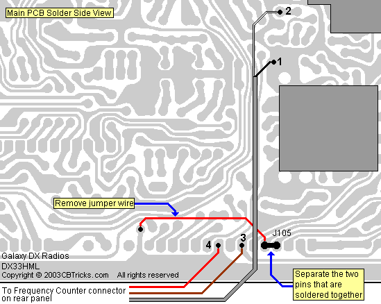

Remove the top cover from the unit and locate the row of 15 pins across the front of the unit. Unsolder the short jumper wire as shown above to pins E and F of J105 (connected together).
2.
Unsolder the shorting solder bridge of pins E and F of J105 so that they are independent pins having no connection between them.
