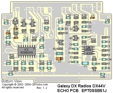

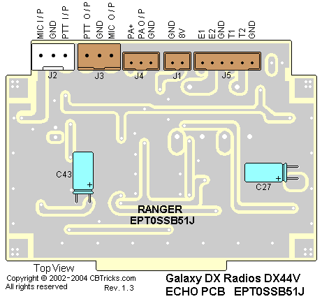

PCB (EPT0SSB51J) Board Layout
Trace Layout

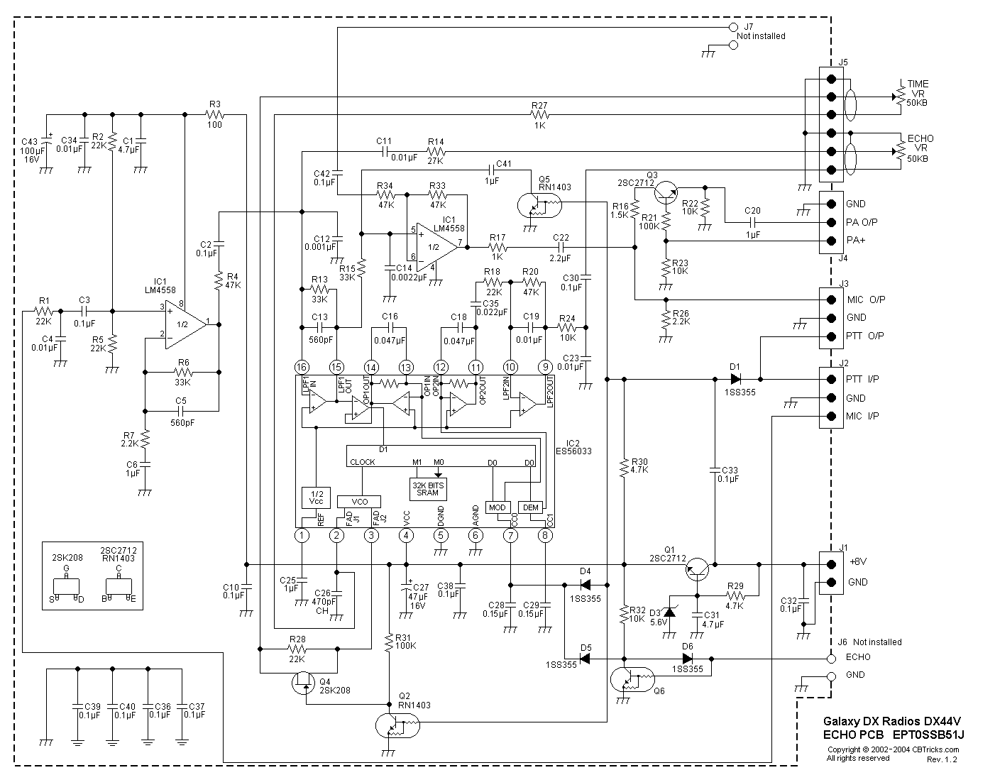

Schematic Diagram
Schematic Diagram
