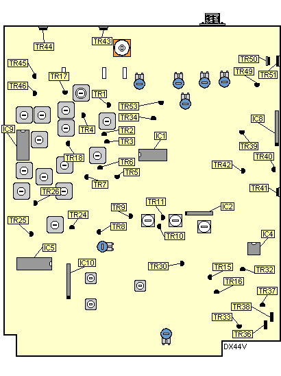

Galaxy DX Radios DX44V
Active Device Location Diagram
TR 1......NB Amp
TR 2......NB Amp
TR 3......NB Amp
TR 4......NB AGC
TR 5......NB Pulse Amp
TR 6......NB Pulse Amp
TR 7......NB Shunt Switch
TR 8......2nd RX Mixer
TR 9......AM/FM IF Amp
TR 10....AM/FM IF Amp
TR 11....AM/FM IF Amp
TR 15....AF Preamp
TR 16....Squelch Switch
TR 17....RX RF Amp
TR 18....1st RX Mixer
TR 19....1st IF Amp
TR 23....AM Det. Switch
TR 24....PLL Ref. Osc.
TR 25....VCO
TR 26....VCO Buffer
TR 30....Carrier Osc.
TR 32....AMC Shunt
TR 34....AMC/ALC Amp
TR 36....RX Voltage Switch
TR 37....RX Voltage Switch
TR 38....TX Voltage Switch
TR 40....Voltage Reg.
TR 41....Voltage Reg.
TR 42....AF Preamp
TR 43....RF Final Amp
TR 44....RF Driver Amp
TR 45....RF Predriver Amp
TR 46....RF Amp And Buffer
TR 49....AM Mod. Amp
TR 50....AM Mod. Amp
TR 51....AM Mod. Amp
TR 53....AMC Amp
IC 1......Squelch & AGC Amp
IC 2......FM Det.
IC 4......Mike Amp & TR Switch
IC 5......PLL Synth.
IC 8......Audio Power Amp
IC 9......TX Mixer
IC 10....PLL Mixer
