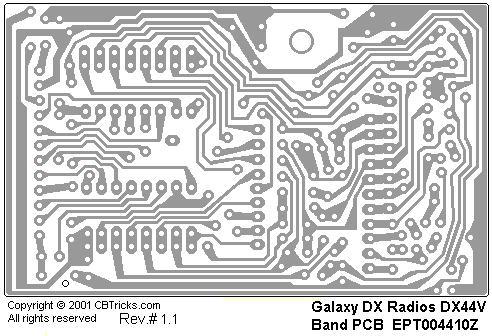

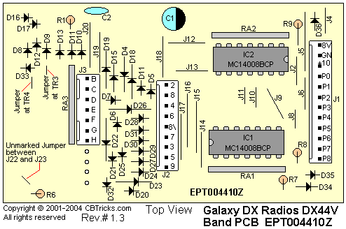

Galaxy
DX Radios DX44V
Band Board Layout (EPT004410Z)
Ref#
Description |
MFR.
Part No.
BAND PCB 82x50x1.6t |
EPT004410Z |
Resistors
Ref#
Description |
MFR.
Part No.
R6 |
C/F/R 47K OHM 1/4W U |
RCU144734Z |
R7 |
RCU144734Z |
R8 |
RCU144734Z |
R9 |
RCU144734Z |
RA1 |
RESISTOR ARRAY 47K 8P |
RCS0870014 |
RA2 |
RCS0870014 |
RA3 |
RCS0870014 |
Capacitors
Ref#
Description |
MFR.
Part No.
C1 |
E/C 220UF 10WV Z |
CE0102277Z |
C2 |
C/C 0.01UF 50WV SL Z |
CCO501037L |
Integrated Circuits
Ref#
Description |
MFR.
Part No.
IC1 |
I.C.(MOTOROLA) MC14008BCP 16PIN |
ENMC14008B |
IC2 |
ENMC14008B |
Diodes
Ref#
Description |
MFR.
Part No.
D4-36 |
DIODE IN4148 |
EDIN04148Z |
Connectors
Ref#
Description |
MFR.
Part No.
J1 |
PCB CONNECTOR/S 12P T PH=2.5 (WHITE) |
EX07N41309 |
J1 |
WIRE CONNECTOR/H 12P |
EX07N48484 |
J2 |
PCB CONNECTOR/S 9P T PH=2.5(WHITE) |
EX07N48083 |
J2 |
WIRE CONNECTOR/H 9P-9PL=150PH=2.5 |
EX07N48483 |
J3 |
PCB CONNECTOR/S 7P T PH=2.5(WHITE) |
EX07N48167 |
J3 |
WIRE CONNECTOR/H 7P |
EX07N48482 |
Jumper Wire
Ref#
Description |
MFR.
Part No.
J4 |
JUMPER WIRE 7x6x1 |
WX01070706 |
J5 |
JUMPER WIRE 7x15x7 |
WX01070715 |
J6 |
JUMPER WIRE 7x8x7 |
WX01070708 |
J7 |
JUMPER WIRE 7x7x7 |
WX01070707 |
J8 |
JUMPER WIRE 7x4x7 |
WX01070704 |
J9 |
JUMPER WIRE 7X9MMX7 |
WX01070709 |
J10 |
JUMPER WIRE 7x5x7 |
WX01070705 |
J11 |
JUMPER WIRE 7x4x7 |
WX01070704 |
J12 |
WX01070709 |
J13 |
JUMPER WIRE 7x8x7 |
WX01070708 |
J14 |
WX01070709 |
J15 |
JUMPER WIRE 7x13x7 |
WX01070713 |
J16 |
WX01070713 |
J17 |
JUMPER WIRE 7x11mmx7 |
WX01070711 |
J18 |
WX01070711 |
J19 |
JUMPER WIRE 7x10x7 |
WX01070710 |
J20 |
WX01070711 |
J22 |
JUMPER WIRE 7x3MMx7 |
WX01070703 |
J23 |
WX01070703 |
TR3 |
WX01070703 |
TR4 |
WX01070703 |
