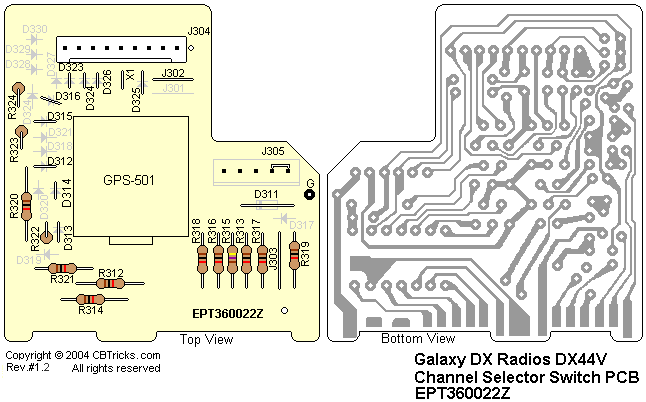

Galaxy
DX Radios DX44V
Documentation Project
CBTricks.com
Channel Selector PCB
Layout (EPT360022Z)
Schematic Diagram
Ref#
Description |
MFR.
Part No.
ROTARY SW P.C.B. Complete with Components |
#T-140H-P02 |
P.C.B. 58X55X1.6 |
EPT360022Z |
Resistors
Ref#
Description |
MFR.
Part No.
R312 |
C/F/R 1K OHM 1/4W M |
RCM141024B |
R313 |
RCM141024A |
R314 |
RCM141024B |
R315 |
C/F/R 470 OHM 1/4W M |
RCM144714A |
R316 |
RCM141024A |
R317 |
RCM141024A |
R318 |
RCM141024A |
R319 |
RCM141024A |
R320 |
RCM141024B |
R321 |
RCM141024A |
R322 |
C/F/R� F-TYPE 1K OHM 1/4W U |
RCU141024Z |
R323 |
RCU141024Z |
R324 |
RCU141024Z |
Switch
Ref#
Description |
MFR.
Part No.
ROTARY SW GPS-0501 |
EWRT32000S |
Connectors
Ref#
Description |
MFR.
Part No.
J304 |
PCB CONNECTOR/S 9P T PH=2.5(WHITE) |
EX07N48083 |
Jumpers
Ref#
Description |
MFR.
Part No.
J302 |
JUMPER WIRE 7x8x7 |
WX01070708 |
J303 |
JUMPER WIRE 7x10x7mm |
WX01070710 |
J305 |
JUMPER WIRE 7x3x7mm |
WX01070703 |
X1 |
JUMPER WIRE 7x4x7mm |
WX01070704 |
D311 |
WX01070710 |
D312 |
WX01070704 |
D313 |
WX01070704 |
D314 |
WX01070704 |
D315 |
WX01070704 |
D316 |
WX01070704 |
D323 |
WX01070704 |
D324 |
WX01070704 |
D325 |
JUMPER WIRE 7x5x7mm |
WX01070705 |
D326 |
WX01070704 |
