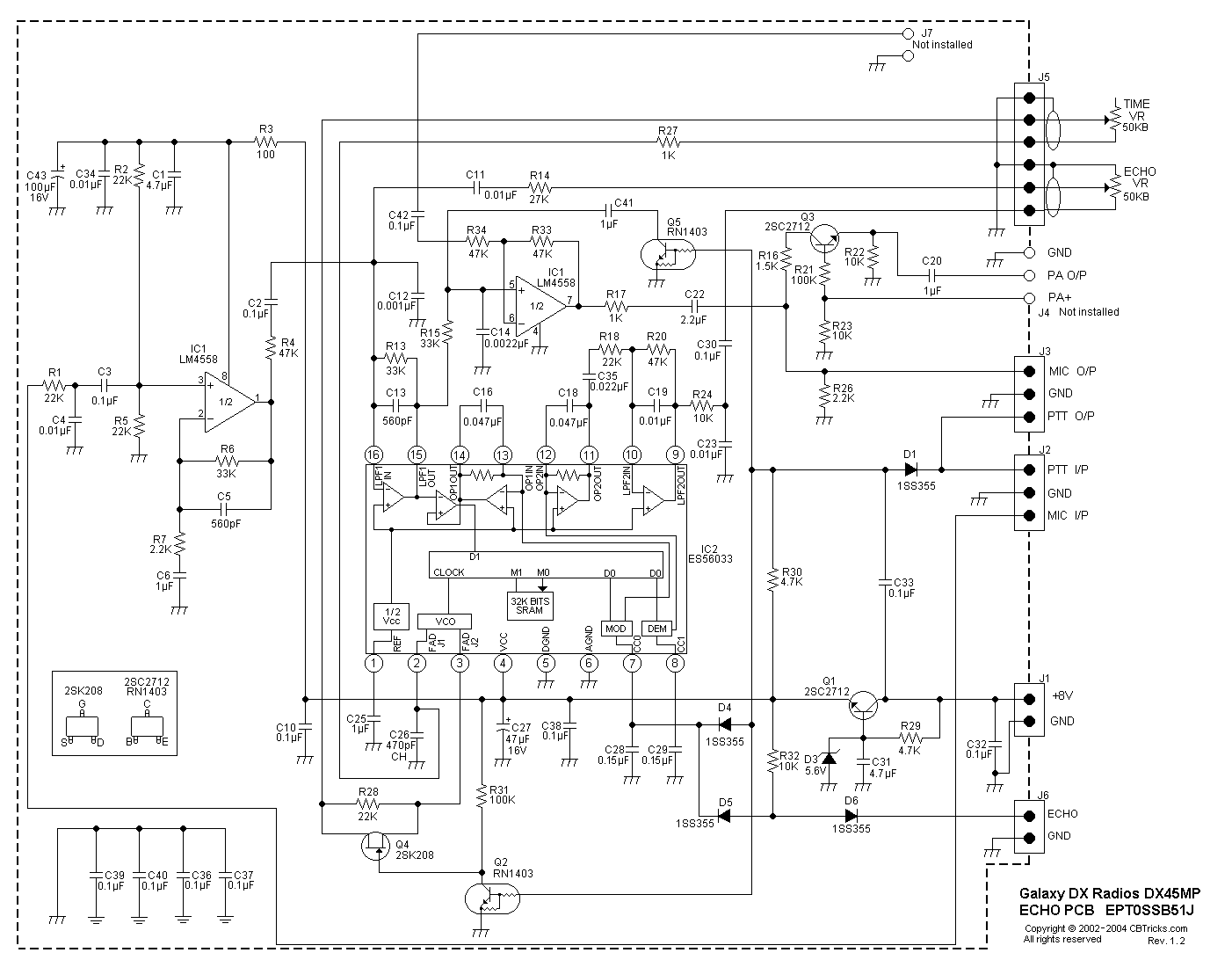

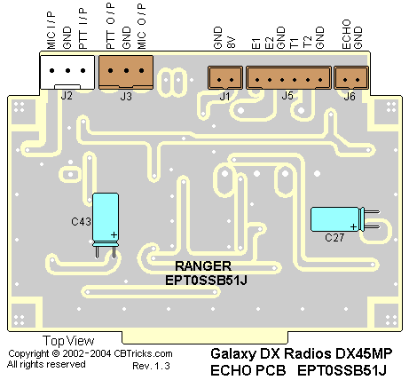

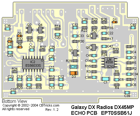

Galaxy
DX Radios DX45MP
Documentation Project
CBTricks.com
ECHO PCB (EPT0SSB51J)
Trace Layout
Schematic Diagram
Schematic Diagram
