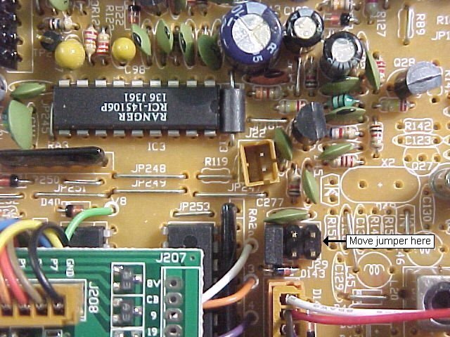

Before
Click to see full size
Shown in stock position

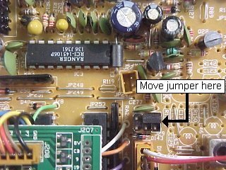

After
Shown in mod position
Frequency Conversion
1.
Remove the cover from the unit and locate 6 pin jumper labeled J29. Move the shorting block from it's current position to the position on the right.
2.
Re-Assemble the unit and check All Bands for Proper operation.
