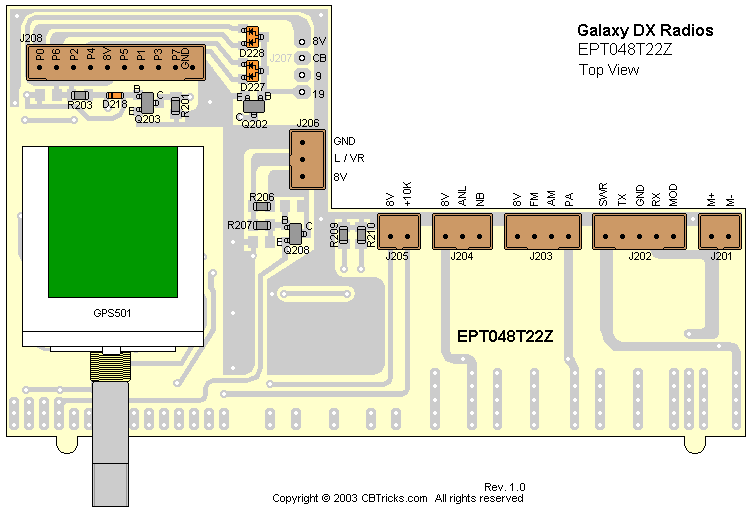

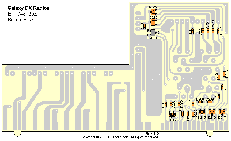

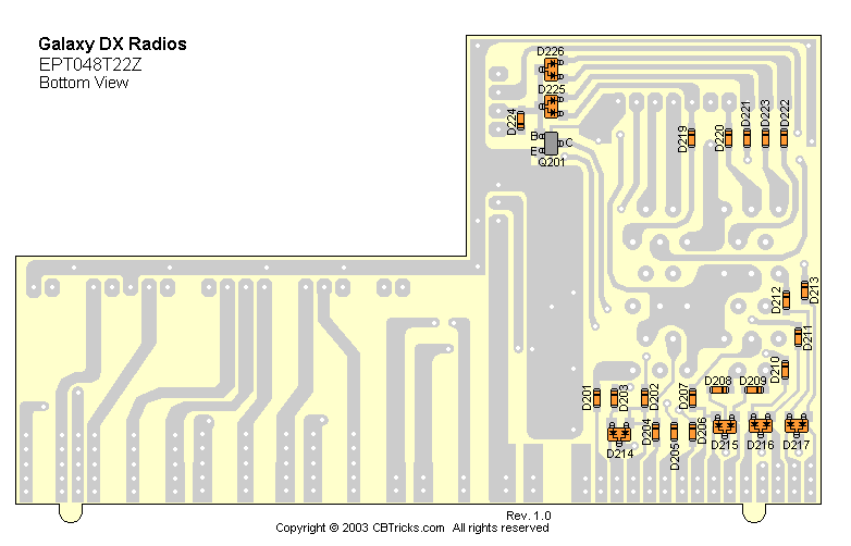

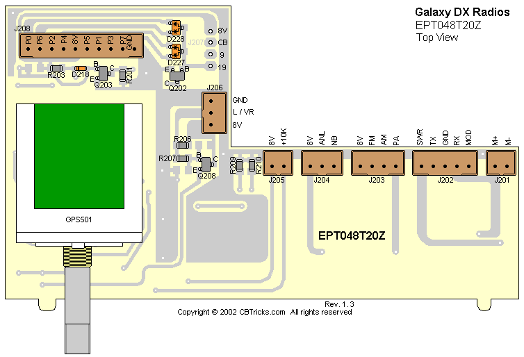

Galaxy
DX Radios DX48T
Channel Selector PCB
(EPT48T20Z)
Trace Layout
Parts List
