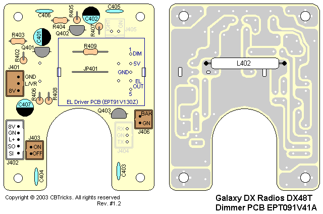

PCB (EPT091V41A)
Trace
Layout

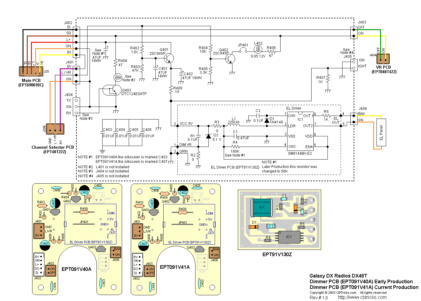

Schematic
Diagram
Schematic
Diagram
