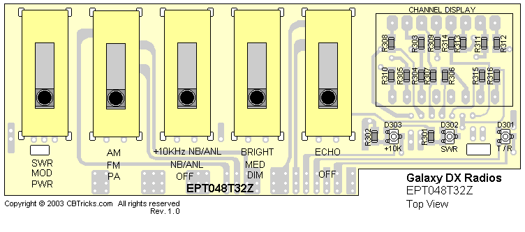

Galaxy DX Radios DX48T
Display / Switch PCB (EPT048T33Z)
Trace Layouts
Resistors
Ref#
Description
MFR. Part No.
R301
CHIP/F/R (S.M.D) 1K OHM 0.1W(0805)
RCY011024Z
R302
RCY011024Z
R303
CHIP/F/R(SMD) 2.2K OHM 0.1W (Blue LED Version)
RCY011024Z
RCY012224Z
R304
RCY011024Z
RCY012224Z
R305
RCY011024Z
RCY012224Z
R306
RCY011024Z
RCY012224Z
R307
RCY011024Z
RCY012224Z
R308
RCY011024Z
RCY012224Z
R309
RCY011024Z
RCY012224Z
R310
RCY011024Z
RCY012224Z
R311
RCY011024Z
RCY012224Z
R312
RCY011024Z
RCY012224Z
R313
RCY011024Z
RCY012224Z
R314
RCY011024Z
RCY012224Z
R315
RCY011024Z
RCY012224Z
R316
RCY011024Z
RCY012224Z
LED's
Ref#
Description
MFR. Part No.
T/R
LED LAMPS (S.M.D.) KM-23ESGC RED/GREEN
EX01Y40114
SWR
LED LAMPS(SMD) KM-23IT(RED)
EX01Y40116
+10K
LED LAMPS(SMD) KM-23SGT(GREEN)
EX01Y40138
CH DISPLAY
LED DISPLAY(GREEN) LDD4062-10 / P10L=15
LED DISPLAY (Blue) LDD406SBKS-10N/P10 P L=15.8
EX03N40483
EX03N40522
Switch
Ref#
Description
MFR. Part No.
ECHO
SLIDE SW 2N
EWSL31026K
SWR
SLIDE SW 3N
EWSL31027K
MODE
SLIDE SW 3N
EWSL31027K
DIM
SLIDE SW 3N
EWSL31027K
NB/ANL/+10K
SLIDE SW 3N
EWSL31027K
