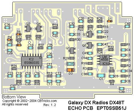

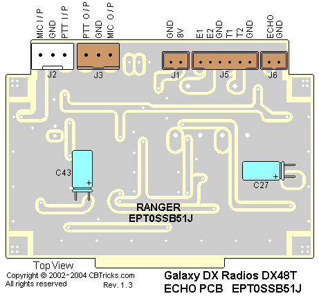

Galaxy
DX Radios DX48T
Documentation Project
CBTricks.com
ECHO PCB (EPT0SSB51J)
Trace Layout

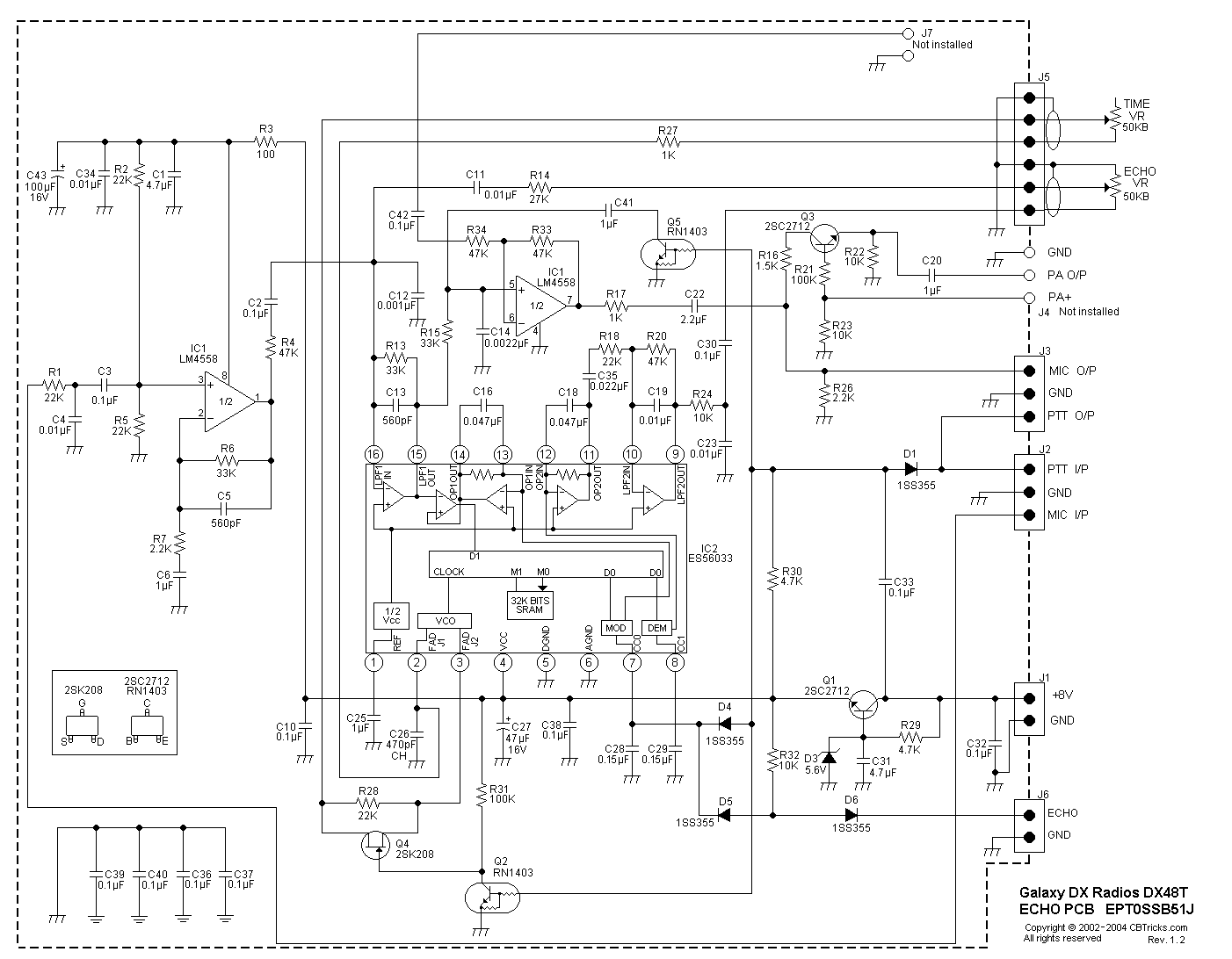

Schematic Diagram
Schematic Diagram
