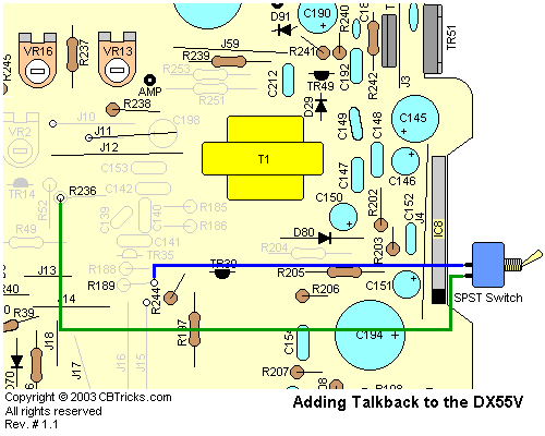

The DX55HP doesn't have talkback from the factory, it can be added by doing the following.
1. Install a (SPST) switch with a wire from one side of the switch to left open hole of R236 (8 volts) and the other wire of the switch going to the empty wire lead hole of R189.
