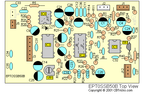

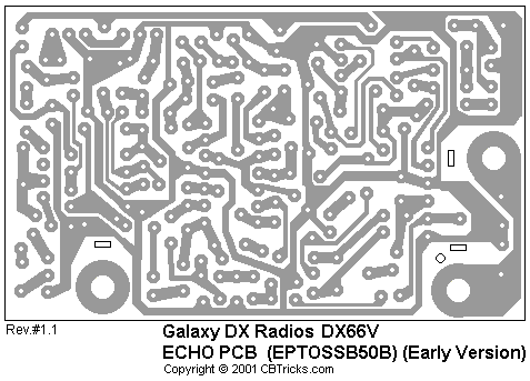

Galaxy
DX Radios DX66V
Documentation Project
CBTricks.com
ECHO
PCB (EPT0SSB50B)
Ref#
Description |
MFR.
Part No.
ECHO P.C.B. EPT0SSB50B |
#T-118C-P02 |
ECHO P.C.B. 98x80x1.6tmm (S) |
EPT0SSB50B |
Potentiometers
Ref#
Description |
MFR.
Part No.
VR1 |
S/F/R VM6CK PV(1S) B50K |
RE50300056 |
Resistors
Ref#
Description |
MFR.
Part No.
R1 |
C/F/R� F-TYPE 1K OHM 1/4W U |
RCU141024Z |
R2 |
C/F/R 39K OHM 1/4W U |
RCU143934Z |
R3 |
C/F/R F-TYPE 100K OHM 1/4W U |
RCU141044Z |
R4 |
C/F/R 100K OHM 1/4W M |
RCM141044A |
R5 |
C/F/R 100 OHM 1/4W M |
RCM141014B |
R6 |
C/F/R F-TYPE 100 OHM 1/4W U |
RCU141014Z |
R7 |
C/F/R 120K OHM 1/4W U |
RCU141244Z |
R8 |
RCU141244Z |
R9 |
RCU141244Z |
R10 |
RCU143934Z |
R11 |
RCU141244Z |
R13 |
RCU141044Z |
R14 |
C/F/R 47K OHM 1/4W U |
RCU144734Z |
R16 |
RCU143934Z |
R17 |
RCU141244Z |
R18 |
RCU141044Z |
R19 |
RCU141044Z |
R20 |
C/F/R 68K OHM 1/4W U |
RCU146834Z |
R21 |
RCU141024Z |
R22 |
RCU143934Z |
R23 |
RCU143934Z |
R24 |
RCU143934Z |
R25 |
RCU143934Z |
R26 |
RCU141244Z |
R27 |
RCU143934Z |
R28 |
RCU144734Z |
R29 |
RCU141014Z |
R30 |
RCU144734Z |
R31 |
C/F/R F-TYPE 4.7K OHM 1/4W U |
RCU144724Z |
R32 |
RCU141244Z |
R33 |
RCU141244Z |
R34 |
RCU141024Z |
R35 |
RCU141014Z |
R41 |
RCU141024Z |
Capacitors
Ref#
Description |
MFR.
Part No.
C1 |
E/C 2.2UF 50WV Z |
CE0502257Z |
C2 |
C/C 0.001UF 50WV SL Z |
CC0501027L |
C3 |
C/C 0.1UF 50WV SL Z |
CC0501047L |
C4 |
E/C 47UF 10WV Z |
CE0104767Z |
C5 |
C/C 220PF 50WV SL K |
CC0502215L |
C6 |
E/C 2.2UF 50WV Z |
CE0502257Z |
C7 |
M/C 0.0033UF 50WV K |
CM0503325Z |
C8 |
E/C 2.2UF 50WV Z |
CE0502257Z |
C9 |
E/C 47UF 10WV Z |
CE0104767Z |
C10 |
CC0502215L |
C11 |
CM0503325Z |
C12 |
CM0503325Z |
C13 |
CC0502215L |
C14 |
E/C 2.2UF 50WV Z |
CE0502257Z |
C15 |
E/C 2.2UF 50WV Z |
CE0502257Z |
C16 |
CM0503325Z |
C17 |
CM0503325Z |
C18 |
CM0503325Z |
C19 |
CC0502215L |
C20 |
E/C 2.2UF 50WV Z |
CE0502257Z |
C21 |
E/C 10UF 25WV Z |
CE0251067Z |
C22 |
M/C 0.001UF 50WV K |
CM0501025Z |
C23 |
E/C 2.2UF 50WV Z |
CE0502257Z |
C24 |
E/C 2.2UF 50WV Z |
CE0502257Z |
C25 |
E/C 2.2UF 50WV Z |
CE0502257Z |
C28 |
E/C 220UF 16WV Z |
CE0162277Z |
C30 |
E/C 47UF 10WV Z |
CE0104767Z |
C31 |
CC0501027L |
C32 |
CC0501027L |
C33 |
CC0501047L |
C34 |
CC0501047L |
C35 |
CC0501047L |
C36 |
CM0503325Z |
Diodes
Ref#
Description |
MFR.
Part No.
D1 |
DIODE 1N4148 |
ED1N04148Z |
Integrated Circuits
Ref#
Description |
MFR.
Part No.
IC1 |
I.C.(SONY) CXA4558P |
ENSO04558P |
IC2 |
I.C.(JRC) NJM324D 14PIN |
ENJR00324D |
IC3 |
I.C.(MATSUSHITA) MN3008���� 8PIN |
ENMA03008Z |
IC4 |
I.C.(MATSUSHITA) MN3101���� 8PIN |
ENMA03101Z |
Connectors
Ref#
Description |
MFR.
Part No.
J1 |
PCB CONNECTOR/S 3P T PH=2.5 |
EX07N41216 |
J1 |
WIRE CONNECTOR/H 3P-3P L=130MM |
EX07N48820 |
J2 |
PCB CONNECTOR/S 3P T PH=2.5(WHITE) |
EX07N41227 |
J3 |
PCB CONNECTOR/S 6P T PH=2.5 |
EX07N41266 |
J3 |
WIRE CONNECTOR/H 6P L=250mm PH=2.5 |
EX07N48446 |
J5 |
PCB CONNECTOR/S 2P PH=2.5 |
EX07N41226 |
J5 |
WIRE CONNECTOR/H 2P L=250mm |
EX07N48279 |
Jumper Wire
Ref#
Description |
MFR.
Part No.
J6 |
JUMPER WIRE 7x5x7mm |
WX01070705 |
J7 |
WX01070705 |
J8 |
JUMPER WIRE 7x10x7mm |
WX01070710 |
J9 |
WX01070710 |
J10 |
WX01070705 |
J11 |
WX01070705 |
