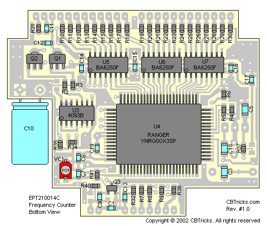

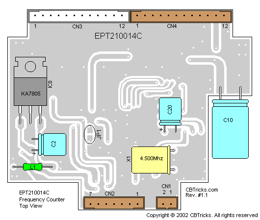

Frequency Counter PCB (EPT210014C)
EPT210014C Trace Layouts

Ref# | Description |
MFR.
Part No.
COUNTER P.C.B. EPT210014C Complete with Components |
#MT-140R-P10 |
COUNTER P.C.B. 62x51x1.6tmm(d) |
EPT210014C |
Resistors
Ref#
Description |
MFR.
Part No.
R2 |
CHIP/F/R (SMD) 4.7K OHM 0.1W |
RCY014724Z |
R3 |
RCY014724Z |
R4 |
CHIP/F/R (SMD) 22K OHM 0.1W |
RCY012234Z |
R5 |
RCY012234Z |
R6 |
RCY012234Z |
R7 |
RCY012234Z |
R8 |
RCY012234Z |
R9 |
RCY012234Z |
R10 |
CHIP/F/R (SMD) 100 OHM 0.1W |
RCY011014Z |
R11 |
RCY011014Z |
R12 |
RCY011014Z |
R13 |
RCY011014Z |
R14 |
RCY011014Z |
R15 |
RCY011014Z |
R16 |
RCY011014Z |
R17 |
RCY011014Z |
R18 |
RCY011014Z |
R19 |
RCY011014Z |
R20 |
RCY011014Z |
R21 |
RCY011014Z |
R22 |
RCY011014Z |
R23 |
RCY011014Z |
R24 |
RCY011014Z |
R25 |
RCY011014Z |
R26 |
RCY011014Z |
R27 |
RCY011014Z |
R28 |
RCY011014Z |
R29 |
RCY011014Z |
R30 |
RCY011014Z |
R31 |
CHIP/F/R (SMD) 330 OHM 0.1W |
RCY013314Z |
R32 |
CHIP/F/R (SMD) 10 OHM 0.1W |
RCY011004Z |
R35 |
CHIP/F/R (SMD) 470 OHM 0.1W |
RCY014714Z |
R36 |
CHIP/F/R (SMD) 10K OHM 0.1W |
RCY011034Z |
R37 |
CHIP/F/R (SMD) 47 OHM 0.1W |
RCY014704Z |
R40 |
RCY011034Z |
R41 |
CHIP/F/R (SMD) 33K OHM 0.1W |
RCY013334Z |
R42 |
CHIP/F/R (SMD) 0 OHM 0.1W |
RCY010004Z |
Capacitors
Ref#
Description |
MFR.
Part No.
C1 |
CHIP/C (SMD) 0.1UF 50WV Z F Y5V |
CK1104AB7R |
C2 |
E/C 100UF 16WV Z (MINI) |
CEM161077Z |
C3 |
CHIP/C (SMD) 0.1UF 25WV M Z5U |
CK2104AA6U |
C5 |
CK2104AA6U |
C6 |
CHIP/C (SMD) 33PF 50WV J CH |
CK1330AB4A |
C7 |
CHIP/C (SMD) 15PF 50WV J CH |
CK1150AB4A |
C9 |
CHIP/C (SMD) 0.001UF 50WV Z SL(K X7R) |
CK1102AB7L |
C10 |
E/C 1000UF 16WV Z |
CE0161087Z |
C11 |
CHIP/C (SMD) 0.01UF 50WV M Z5U |
CK1103AB6U |
C12 |
CK1103AB6U |
C13 |
CK1103AB6U |
C14 |
CK1103AB6U |
C15 |
CK1103AB6U |
C16 |
CK1103AB6U |
C17 |
CK1103AB6U |
C18 |
CK2104AA6U |
C19 |
CK1103AB6U |
C20 |
CEM161077Z |
VC1 |
TRIMMER/C (SMD)20PF TCZ03P200A110B00 |
CV038200AY |
Integrated Circuits
Ref#
Description |
MFR.
Part No.
U1 |
IC (SMD) TC4093BFN 14PIN |
YNTA04093B |
U4 |
I.C. LC7232N-8985 80PIN |
YNRG0GX3SP |
U5 |
IC (SMD) BA6250F-TP 16PIN |
YNRO06250F |
U6 |
YNRO06250F |
U7 |
YNRO06250F |
IC8 |
I.C.(SGS) L7805 |
ENSG07805Z |
Transistors
Ref#
Description |
MFR.
Part No.
Q1 |
T/R (SMD) 2SB798DL-(T1) |
TY2SB0798Z |
Q2 |
TY2SB0798Z |
Q3 |
T/R (SMD) 2SC2714-TE85L |
TY2SC2714Z |
Inductors
Ref#
Description |
MFR.
Part No.
L1 |
CHOKE COIL 470UH |
ECCHK16096 |
Crystals
Ref#
Description |
MFR.
Part No.
X1 |
CRYSTAL HC-49/U 4.500MHz |
EYCAP04500 |
Connectors
Ref#
Description |
MFR.
Part No.
CN1 |
PCB CONNECTOR/S 2P PH=2MM |
EX07N48223 |
CN1 |
WIRE CONNECTOR/H 2P-2P |
EX07N48745 |
CN2 |
PCB CONNECTOR/S 7P PH=2MM |
EX07N48224 |
CN2 |
WIRE CONNECTOR/H 7P L=200MM PH=2MM |
EX07N48875 |
CN3 |
PCB CONNECTOR/S 12P PH=2(WHITE) |
EX07N48767 |
CN4 |
PCB CONNECTOR/S 12P PH=2 |
EX07N48150 |
Hardware
Ref#
Description |
MFR.
Part No.
COUNTER COVER |
MT2100061X |
COUNTER BOX |
MT2100070X |
BRACKET COUNTER BOX |
MT2100081X |
SPONGE 50x30x3t |
XZZZ90198Z |
SET SCREW M3x0.5Px6 |
JS053006MN |
(1) |
SET SCREW M3x0.5Px8 |
JS013008MV |
